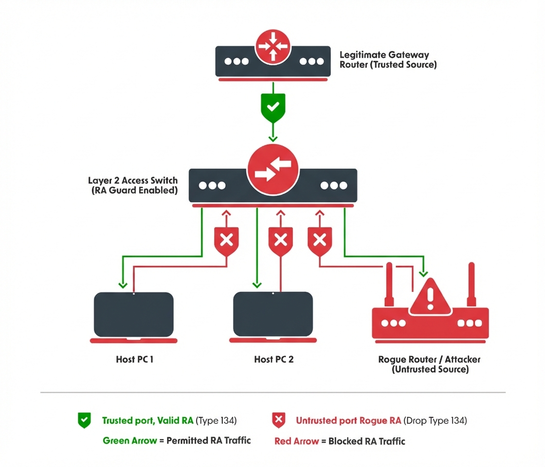

ra-guard (yes | no; Default: no)RA guard - security feature that validates incoming Router Advertisements against a list of authorized, trusted ports.

trusted-ra (yes | no; Default: no)Specifies whether the port is permitted to forward IPv6 Router Advertisement messages; set to yes for ports connected to legitimate routers and no to block unauthorized sources. This property only has an effect when ra-guard is set to yes.

RA Guard
The RA guard feature is intended for discarding IPv6 packets containing router advertisement (RA) messages arriving on bridge ports specified by the user as untrusted ones, thereby allowing one to prevent potential rogue RA message-based attacks or accidental network misconfiguration. When enabled, it is possible to set each bridge ports either as trusted, or untrusted (by default all the bridge ports are set as RA untrusted).
Here is the network scheme and core principle behind IPv6 RA Guard (Router Advertisement Guard).
#Layer 2 Access Switch - enabling RA guard on the main bridge
add name=bridge
set [find where name="bridge"] ra-guard=yes
add bridge=bridge interface=etherUplink Trusted RA=yes
add bridge=bridge interface=etherX
add bridge=bridge interface=etherY
add bridge=bridge interface=etherZ
The Problem: Why is this needed?
In IPv6, devices use ICMPv6 to auto-configure themselves.
Router Advertisements (Type 134): Routers broadcast these messages to tell hosts: "I am the gateway, and here is your network prefix."
The Threat: If a user accidentally connects a consumer router (like a home Wi-Fi router) or a malicious actor launches a tool (like Rogue RA) on an access port, that device will start broadcasting RAs.
The Result: Other hosts on the network will auto-configure their IPv6 addresses based on the rogue device and set the rogue device as their default gateway. This causes a Man-in-the-Middle attack or a complete denial of service.
The Core Principle: "Trust vs. Untrust"
The fundamental principle of IPv6 RA Guard is logically identical to DHCP Snooping in IPv4. It creates a security boundary within the Layer 2 switch infrastructure by categorizing switch ports into two roles:
  • Trusted Ports: Ports connected to legitimate, authorized IPv6 routers. These ports are allowed to send Router Advertisement (RA) packets.
  • Untrusted Ports: Ports connected to end-user hosts. These ports are blocked from sending RA packets.
Packet parsing process
For ports not configured as RA Trusted, the RA Guard parser traverses the extension header chain until it encounters a non-extension header. The parsing process and subsequent actions are governed by the following rules:
Transport Layer Termination: If the parser encounters a valid transport layer header—such as TCP, UDP, ESP, RSVP, or an encapsulated IPv4/IPv6 header—parsing terminates and the packet is forwarded (subject to standard bridge checks).
  • Drop Conditions - The packet is discarded if:
    1. It fails to contain a transport layer header.
    2. The final extension header in the chain does not specify NO_NEXT_HEADER (59) in its "Next Header" field.
    3. If the ICMP message type is found to be 134, the packet is dropped.
  • Fragmentation Handling: These parsing rules apply exclusively to the first fragment of fragmented IPv6 packets. Subsequent fragments are forwarded regardless of their content, as they do not contain the protocol headers necessary for RA identification.
