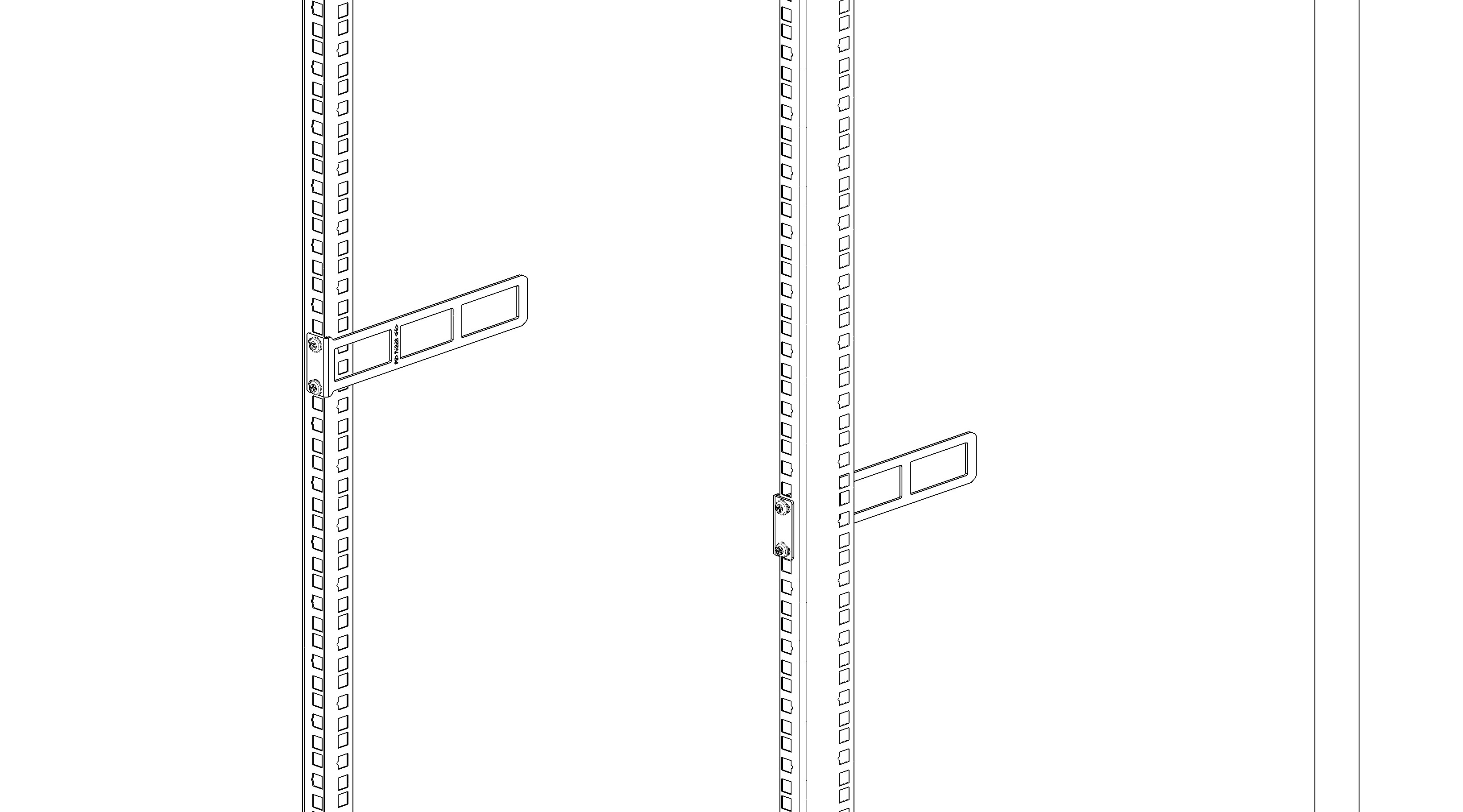

Mounting

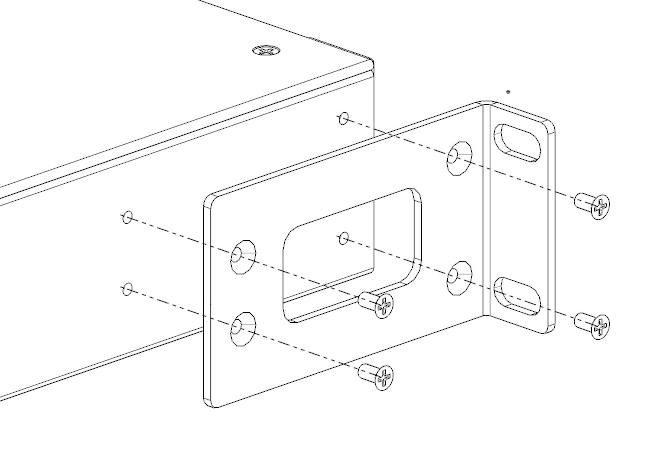

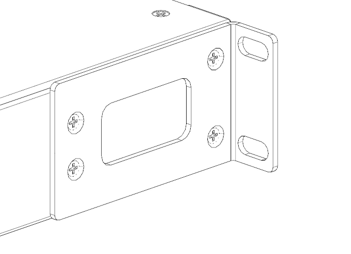

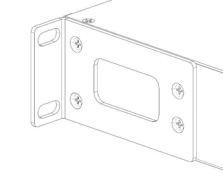

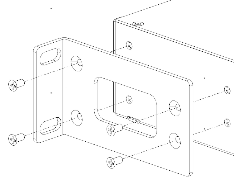

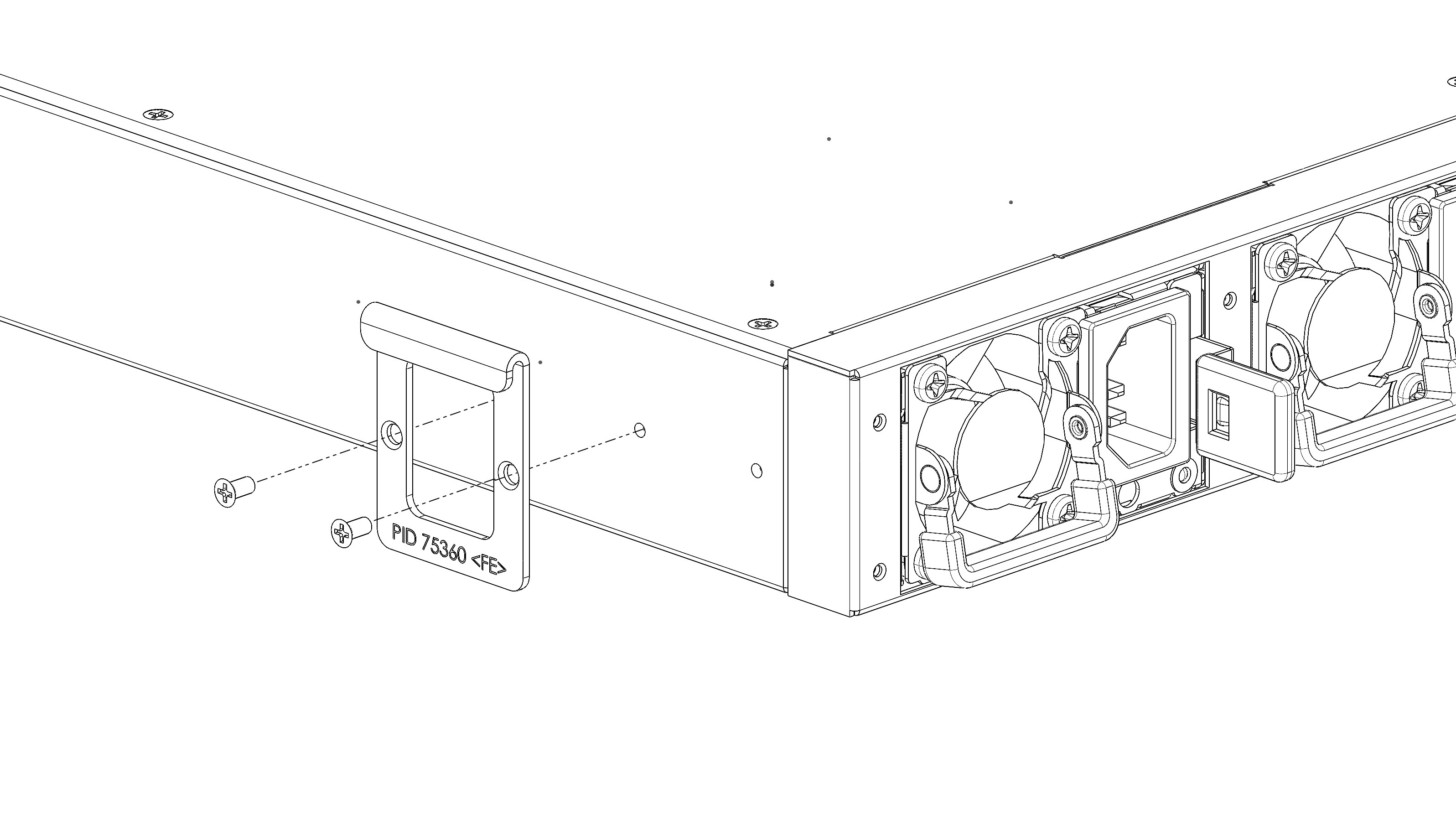

The device is designed for indoor use and can be either mounted in a rack enclosure using the provided rackmount brackets or simply placed on a desktop. Please attach rubber pegs on the bottom of the router if the desired placement is on the flat surface or use a Phillips screwdriver to attach rackmount ears on both sides of the device if designated use is for rackmount enclosure:
  1. Attach the Rackmount ears to the front sides of the device.
2. Attach the small rear Rackmount support ears to both sides of the device.
3. Attach the long rear Rackmount support ears to the rack’s rear side.
4. Install the device in the rack, ensuring that the case support ears are securely fixed to the long support ears.
