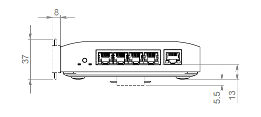

This indoor switch offers multiple mounting options, including a side DIN rail mount and standard screw points on the back for easy integration. The DIN rail mount can also be repositioned to the back.

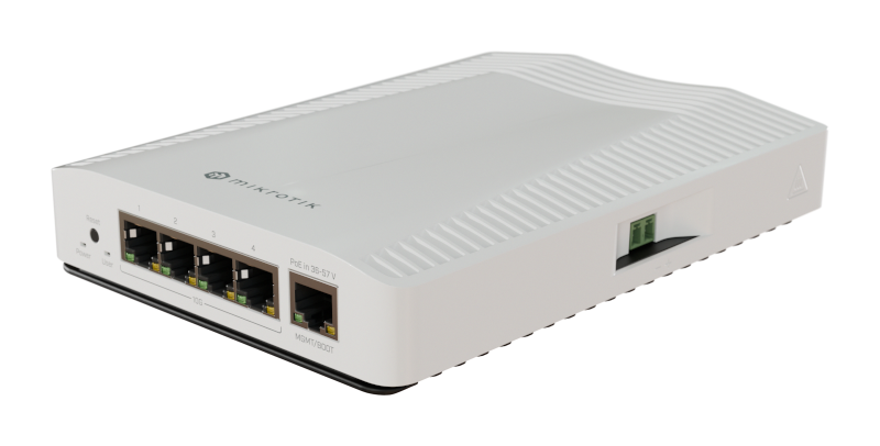

  • Four 1G/2.5G/5G/10G Ethernet ports.
  • One Gigabit Ethernet port, suggested to be used for management (Supports Auto MDI/X so you can use either straight or cross-over cables for connecting to other network devices). The MGMT/BOOT Ethernet port can also be used for network booting and recovery with Netinstall.
