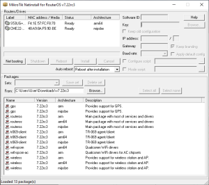

The available actions and parameters are as follows:
Controls/ActionsDescription
Netbooting
Allows to Enable, Disable and configure  IP addressing for Netinstall build-in in BOOTP and TFPT server required for netbooting MikroTik device using Netinstall client
Shutdown
Performs shutdown of selected MiktoTik device booted to Netinstall
Reboot
Performs reboot of selected MiktoTik device booted to Netinstall
Install
Performs MiktoTik device Netinstall using selected options
Cancel
Cancel current in progress installation
Routers/Drives
Device selection for Netinstall.
For device to appear in list device must be started to Netinstall mode
Packages
Allows to specify location where RouterOS packages files are located and create package sets  for next installations
Netinstall parametersDescription
Auto reboot
Set action what is performed after device installation is successfully completed
Software ID
Displays current device Software ID
Key
Allows to specify and install new license key during installation.
By default Netinstall will keep detected license key from device.
Keep old configuration
Instruct Netinstall to read and restore device core configuration (/export; /users) after device installation.
This options does not keep user files, containers etc.
Keep branding
Instruct Netinstall to keep device branding package if it present on device.
Factory installed branding packages can not be discarded and always will be kept.
Apply default config
If set,  after device installation and reboot device will apply default configuration script.
/system/default-configuration/script/print
Configure script
Allows during device installation to install on device custom default configuration script which replaces with RouterOS supplied default configuration script.
/system/default-configuration/custom-script/print
This script will be kept during RouterOS updates and used after further configuration resets till device will be reinstalled with new script or removed if no script provided.
Mode script
Specifies a one‑time custom script to run on the device’s first boot after installation.
Use this script  to configure device‑mode and protected‑routerboot and other settings during device deployment.
Mode script executes before any custom or default configuration scripts. Upon completion, script is automatically removed from the device. If the script modifies the device-mode, the device will be reboot immediately after execution.
This feature requires RouterOS and Netinstall version 7.22 or newer.
IP address Gateway Baudrate
Netinstall will autocreate Configure script with specified parameters for initial device configuration using IPv4 connectivity or serial console.
Parameter available only when device is Installed to empty configuration, eg no other configuration option options specified.

Installed branding package detected
Discovered RouterBOARD... 74:4D:28:8E:86:74
Formatting...
Sending package routeros-7.14.2-arm.npk ...
Sending package wireless-7.14.2-arm.npk ...
Sending empty config ...
Ready for reboot...
Sent reboot command

At this point your device is in Etherboot mode, now the device should show up in your Netinstall window.
