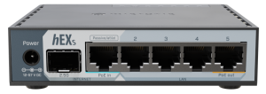

  • Five individual 10/100/1000 Gigabit Ethernet ports, supporting automatic cross/straight cable correction (Auto MDI/X), so you can use either straight or cross-over cables for connecting to other network devices.
  • One SFP module cage supports 2.5 G modules.
  • One USB 3.0 type-A.
