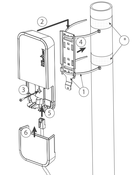

Mounting on the mast or pole:
* It's recommended to use electrical tape to increase friction between materials.
  1. Mount plastic tie straps to steel brackets guiding them through holes.
  2. Mount bracket to the device.
  3. Secure them with a screw.
  4. Mount and align the device on the pole or mast.
  5. Guide Ethernet cable through the opening and connect to the Ethernet port.
  6. Close bottom latch and secure with a screw.
 It's recommended to secure Ethernet cable to the pole using zip ties. With the distance from the device approximately 30 cm.

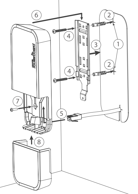

Mounting unit on the wall:
  1. Use included a template to mark spots for drilling holes. And if needed for Ethernet cable. Align accordingly, it will depend on how the device will be mounted finally.
  2. Insert dowels if needed, depends on wall structure and material.
  3. Place included a steel bracket on the wall.
  4. Use screws to secure it in the place.
  5. Extend your Ethernet cable through the opening and connect to the Ethernet port.
  6. Mount the device on the steel bracket
  7. Secure it in place with the screw.
  8. Close bottom latch.
Avoid mounting the device on the low ground spot, as you won't be able to attach and close the bottom latch.

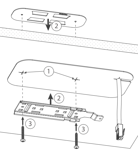

Mounting on the ceiling:
A Special bracket is included in the package to mount on the drop ceiling. As it consists of two parts, to be attached on both sides of the ceiling tile.
  1. Use the template to mark spots for holes.
  2. Place both mounting brackets on the spot.
  3. Secure them together using screws.
Continue assembling in the same manner if mounting on the wall.
  1. Extend your Ethernet cable through the opening and connect to the Ethernet port.
  2. Mount the device on the steel bracket.
  3. Secure it in place with the screw.
  4. Close bottom latch.

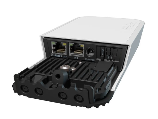

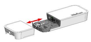

Bottom Lid
  • The bottom lid is secured in place with the captive screw.
  • Use the Philips PH2 screwdriver to unscrew it, but do not remove the screw completely.
  • Pull the cover in the opposite direction from the device to remove it.
  • Reassemble.
Powering
The device accepts power from the power jack or from the Ethernet port, both provided in the package:
  • Direct-input power jack (5.5 mm outside and 2 mm inside, female, pin positive plug) accepts 12-57 V ⎓ DC;
  • Ethernet port accepts 802.3af/at PoE 18-57 V ⎓ DC.
The power consumption under maximum load can reach 9 W. Please attach ground (earth) wire to the screw under the bottom lid.
Connecting to a PoE Adapter:
  1. Connect the Ethernet cable from the device to the PoE+DATA port of the PoE adapter;
  2. Connect an Ethernet cable from your local network (LAN) to the PoE adapter;
  3. Connect the power cord to the adapter, and then plug the power cord into a power outlet.
The grounding screw is located under the bottom lid:
