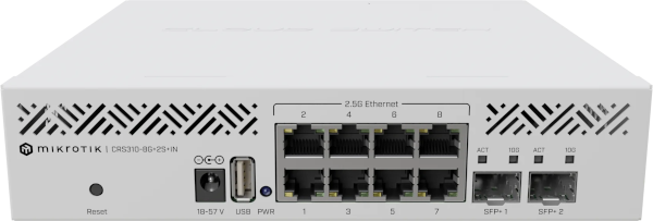

Extension Slots and Ports
ParameterSpecification
Product CodeCRS310-8G+2S+IN
CPU98DX226S, 800 MHz
CPU ArchitectureARM 32bit
CPU Core Count2
Switch Chip Model98DX226S
RAM256 MB DDR3
Storage32 MB Flash
2.5G Ethernet (RJ45)8
10G SFP+2
Operating SystemRouterOS v7 (License Level 5)
Operating Temperature-40°C to +60°C
Case Dimensions200 × 206.1 × 44 mm

Reset button
  • To reset the configuration, unplug the device from power, press and hold the Reset button, and release it when the USER (USR) LED starts flashing.
  • To load the backup bootloader, press and hold the Reset button before applying power, then release it after three seconds.
  • To initiate the Netinstall process (booting the device in BOOTP mode to reinstall RouterOS), press and hold the Reset button, power on the device, and wait for the USER (USR) LED to flash, then become stable. When the USR LED turns off, release the Reset button.
Regardless of the above option used, the system will load the backup RouterBOOT loader if the button is pressed before power is applied to the device. Useful for RouterBOOT debugging and recovery.
LED indicators
  • The power LED is lit when the router is powered by the DC jack or PoE.
  • The user LED can be configured from RouterOS.
  • The port LEDs indicate the individual Ethernet and SFP port activity.
