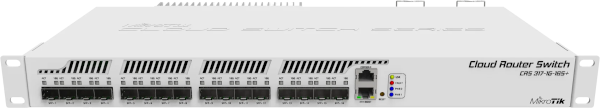

Mounting
The device is designed to use indoors and it can be mounted in a rackmount enclosure using provided rack mounts, or it can be placed on the desktop. Please attach rubber pegs on the bottom of the router if the desired placement is on the flat surface or use a Phillips screwdriver to attach rackmount ears on both sides of the device if designated use is for rackmount enclosure:
  1. Attach rack ears to both sides of the device and tighten four screws to secure them in place, as shown in the picture.
  2. Place the device in the rackmount enclosure and align with the holes so that the device fits conveniently.
  3. Tighten screws to secure it in place.

Extension slots and ports
Product CodeCRS317‑1G‑16S+RM
CPU98DX8216, 800 MHz
CPU ArchitectureARM 32bit
CPU Core Count2
Switch Chip Model98DX8216
RAM1 GB
Storage16 MB Flash
1G Ethernet (RJ45)1
10G SFP+ Ports16
Serial Console (RJ45)1
Operating SystemRouterOS (license level 6) / SwitchOS (dual boot)
Operating Temperature‑20 °C to +60 °C
Case Dimensions443 × 224 × 44 mm
