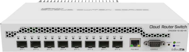

 This device is a network switch with eight SFP+ ports and one-gigabit port. It is already configured, with all ports switched together.

  • The power LED is lit when the router is powered from the DC jack or PoE.
  • The user LED can be configured from RouterOS.
  • The port LEDs indicate the individual Ethernet and SFP port activity.

Product CodeCRS309‑1G‑8S+IN
CPU98DX8208, 800 MHz
CPU ArchitectureARM 32bit
CPU Core Count2
Switch Chip Model98DX8208
RAM512 MB
Storage16 MB Flash
1G Ethernet (RJ45)1
10G SFP+ Ports8
Operating SystemRouterOS / SwOS (Dual boot)
Operating Temperature‑40 °C to +70 °C
Case Dimensions272 × 191 × 44 mm
