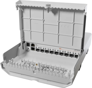

Expansion slots and ports
  1. DC power connector 18 – 57 V.
  2. LED indicating a power state of the device.
  3. A number of 1G SFP ports - 5.
  4. A number of 10G SFP+ ports - 4.
  5. Reset button.

Bottom Lid
  1. The bottom lid is secured in place with the captive screw, it can be unscrewed by hand, but do not remove the screw completely.
  2. Pull the cover towards.
  3. Lift to access Ethernet ports.
