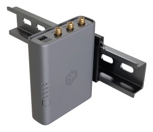

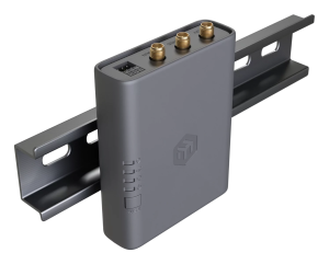

Mounting
  1. The device can be mounted using the provided K-91 fastening set either on the back or on the side of the device using the DIN rail mount set. It is designed to fit standard 35 mm × 7.5 mm DIN rails. Attach the mount to the device using the two provided screws, then attach the device to the DIN rail. The DIN rail is not included in the package.
  2. Alternatively, it is possible to attach the device to a wall, using the provided screw holes on the back of the unit. The device should be mounted in a way that the cable openings are pointing downward as shown in the picture.

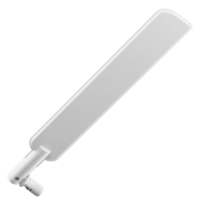

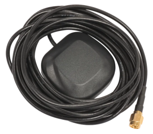

Antenna Connections
PortFunctionRole in ConnectivityNotes
MAINPrimary cellular transmit & receive antennaRequired for all data transmission and receptionMust be connected for the modem to operate
DIV (Diversity)Secondary cellular receive-only antennaImproves signal quality and reliability by receiving the signal from a different spatial pathOptional, but recommended in weak-signal or mobile environments
GNSSGNSS (GPS) receive antennaEnables satellite positioning (GPS/GNSS) functionalityRequired only if GNSS/location services are used
How They Work Together
The MAIN antenna handles both transmission (TX) and reception (RX) and is mandatory for operation.
The DIV antenna provides receive diversity, allowing the modem to select the better of two received signals, improving stability and potential throughput.
This configuration forms the device’s 2×2 MIMO implementation for cellular connectivity.
The GNSS antenna is independent of cellular operation and is used only for satellite positioning.
Practical Considerations
  • If only one cellular antenna is used, it must be connected to the MAIN port.
  • Adding a DIV antenna is strongly recommended in weak-signal environments.
  • For best performance, position MAIN and DIV antennas with some physical separation or different orientation.
  • Install the GNSS antenna with clear sky visibility for accurate positioning.

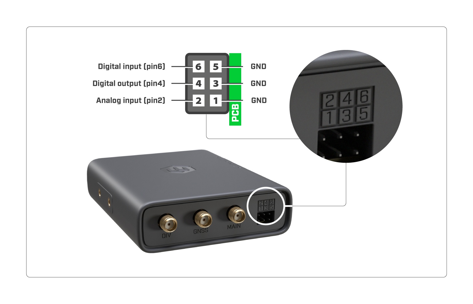

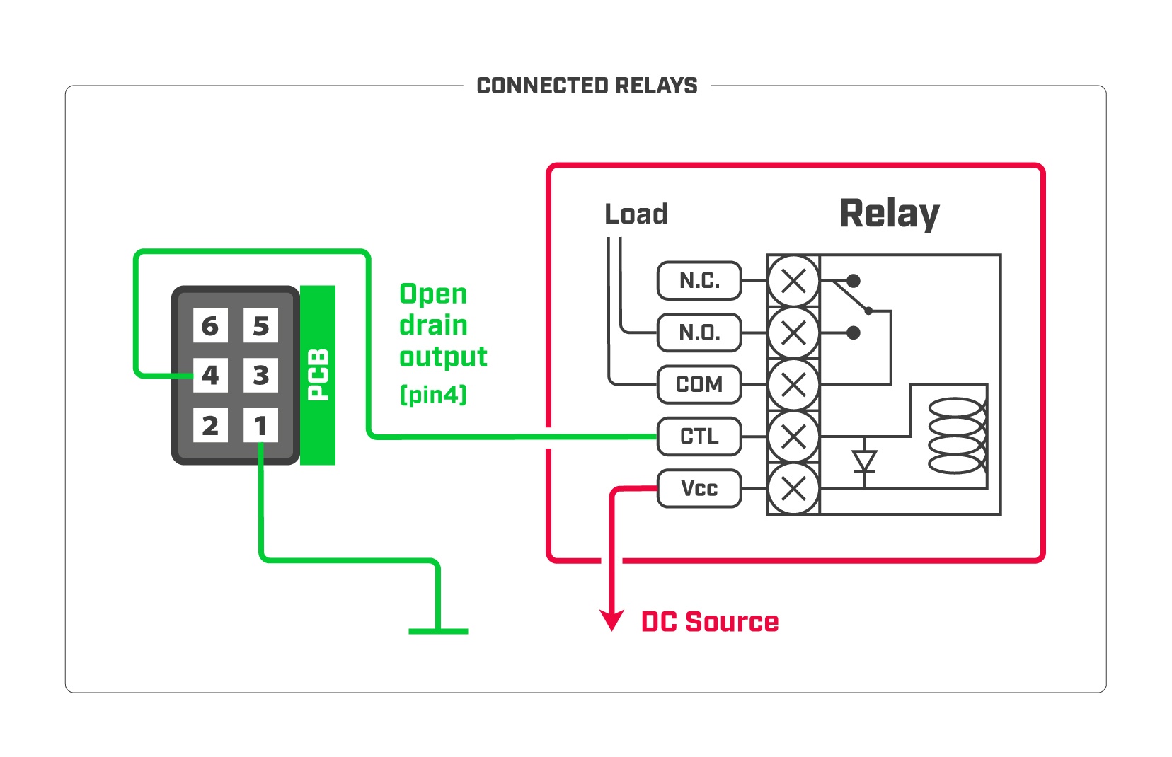

GPIO pinout
GPIO pins are located on the board under the case as shown in the picture:

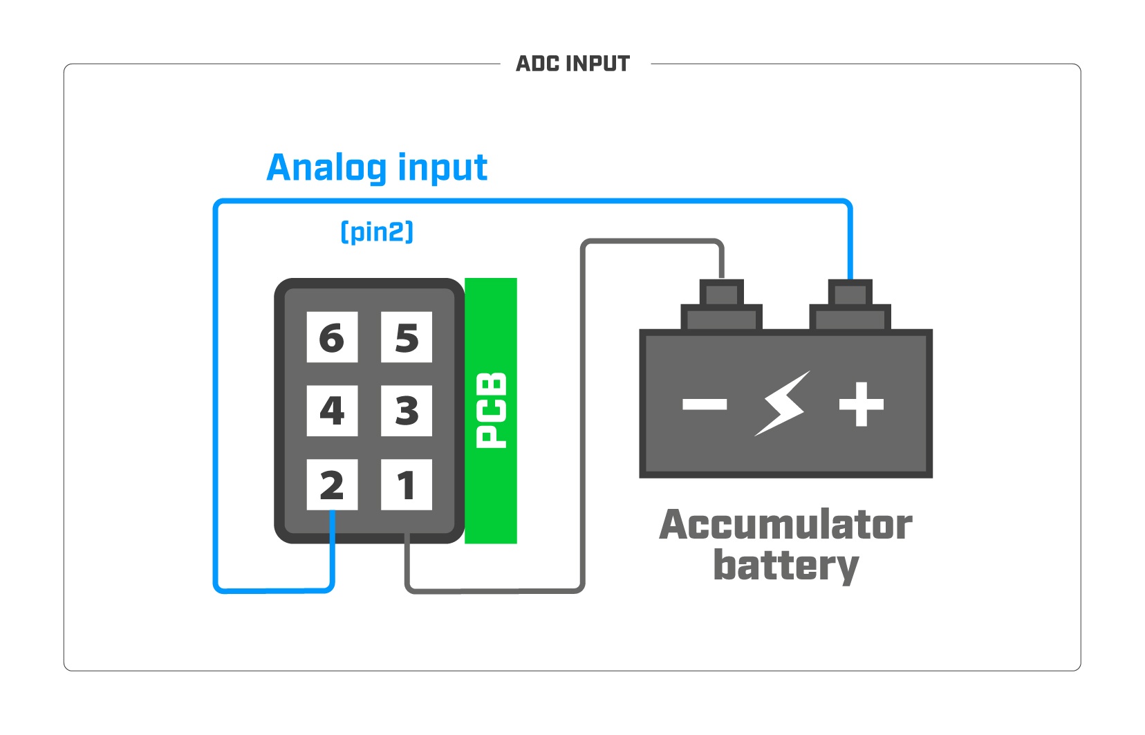

ADC input/analog input (pin2):
note: Analog input voltage is 0-24 V. Theoretical resolution is 1.5 mV (14bit ADC). Analog input impedance is approximately 72K Ohm.

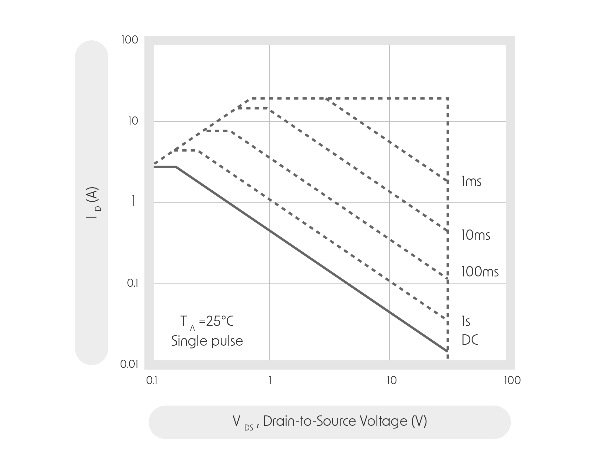

Connected relays (pin4):
note: The maximum power dissipation (for digital output open drain transistor) is 0.48 W.It is recommended not to exceed 24V or 0.5A during continuous operation. Absolute maximum drain-source voltage is 30V , and the maximum amperage is 2.8A .

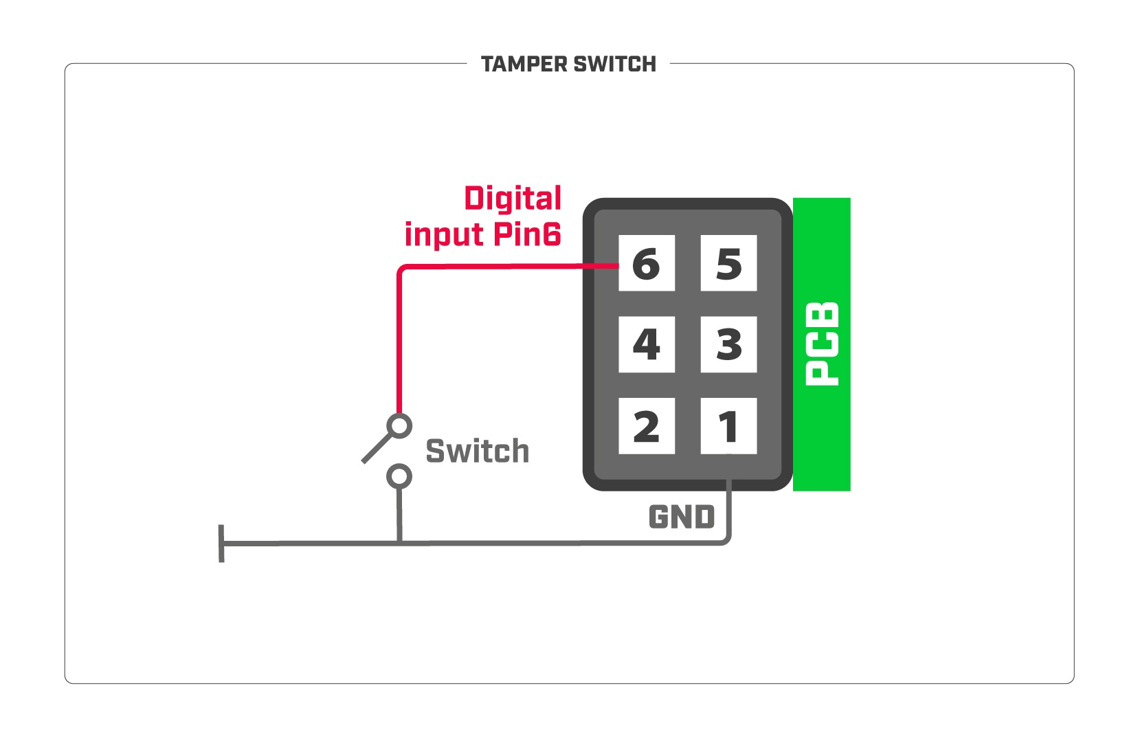

Tamper switch (pin6):
note: Digital input voltage is 0-24 V max.
Tamper switch: Input is equipped with internal Pull-up resistor. To receive a logical "0" on the pin, the voltage should be between 0-1.2 V;
To receive a logical "1" on the pin, the voltage should be between 1.2-24V.

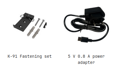

Accessories
The package includes the following accessories that come with the device:
Antennas can be purchased separately
