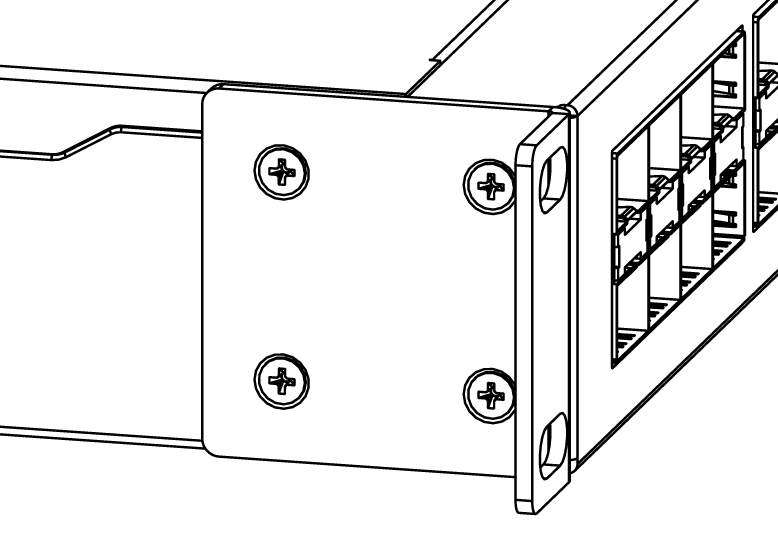

For rack installation, use a Phillips screwdriver to attach the rackmount ears on both sides of the device:
- Attach the rackmount ears and the rear support ears to both sides of the device and tighten the four screws to secure them, as shown in the picture.
Place the device in the rackmount enclosure and align it with the mounting holes.
Tighten the screws to secure the device in place.
