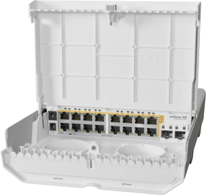

Expansion slots and ports
  1. DC power connector 48 – 57 V.
  2. DC power connector 18 – 30 V.
  3. LED indicating a power state of the device.
  4. Reset button.
  5. Gigabit Ethernet, 8 - ports, delivering PoE out.
  6. Gigabit Ethernet, 8 - ports, delivering PoE out.
  7. Two - 10G SFP+ ports.
  8. LED Indicating the activity of SFP port.
  9. LED Indicating the speed of SFP port.
