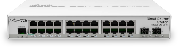

Extension slots and ports
Product CodeCRS326‑24G‑2S+IN
CPU98DX3236, 800 MHz
CPU ArchitectureARM 32bit
CPU Core Count2
Switch Chip Model98DX3236
RAM512 MB
Storage16 MB Flash
1G Ethernet (RJ45)24
10G SFP+ Ports2
Serial Console (RJ45)1
Operating SystemRouterOS (license level 5) / SwOS (Dual boot)
Operating Temperature‑40 °C to +60 °C
Case Dimensions285 × 144 × 44 mm
