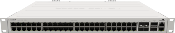

CRS354-48P-4S+2Q+RM
The CRS354 is a network switch with 48 Gigabit ports supporting PoE out for your devices, four 10G SFP+ ports, two 40G QSFP+ ports. The device is ready to use as a switch.
