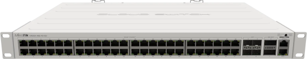

CRS354-48G-4S+2Q+RM
The CRS354-48G-4S+2Q+RM is a network switch with 48 Gigabit ports and four 10G SFP+ ports, and two 40G QSFP+ ports. The device is ready to use as a switch.

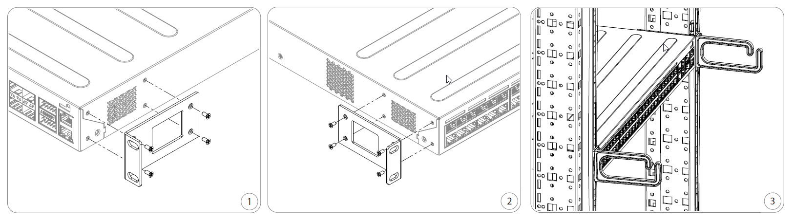

Mounting
The device is designed to use indoors and it can be mounted in a rackmount enclosure using provided rack mounts, or it can be placed on the desktop. Use a Phillips screwdriver to attach rackmount ears on both sides of the device:
  1. Attach the Rackmount ears to the front right side.
  2. Attach the Rackmount ears to the front left side.
  3. If needed, install cable management brackets.
The device has no protection from water contamination, please ensure the placement of the device in a dry and ventilated environment.
We recommend Cat6 cables for our devices.
The mounting and configuration of this device should be done by a qualified person.
