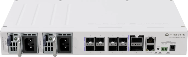

The device is designed to use indoors and it can be mounted in a rackmount enclosure using provided rack mounts, or it can be placed on the desktop. Please attach rubber pegs on the bottom of the router if the desired placement is on the flat surface or use a Phillips screwdriver to attach rackmount ears on both sides of the device if the designated use is for rackmount enclosure:
  1. Attach rack ears to both sides of the device and tighten four screws to secure them in place, as shown in the picture.
  2. Place the device in a rackmount enclosure and align it with the holes so that the device fits conveniently.
  3. Tighten screws to secure it in place.
The IP rating scale for this device is IPX0. The device has no protection from water contamination, please ensure the placement of the device in a dry and ventilated environment. We recommend shielded Cat5/6 cables for our devices. The mounting and configuration of this device should be done by a qualified person.

The device is equipped with an RJ45 serial port, set by default to 115200 bit/s, 8 data bits, 1 stop bit, no parity. For recovery purposes, it is possible to reinstall the device from the network, see the Reset button.

  • Number of DC inputs 3 (PoE-in, DC jack, 2-pin terminal)
  • PoE-in input Voltage 43-57 V Passive PoE or 802.3bt Class 6
  • DC jack input Voltage 36-57 V
  • 2-pin terminal input Voltage 36-57 V
  • Number of AC inputs 2
  • AC input range 100-240 V
  • Frequency 47-63 Hz
  • Max power consumption without attachments 27 W
  • Max power consumption 45 W
Expansion slots and ports
  • Product code CRS510-8XS-2XQ-IN
  • CPU QCA9531 650 MHz
  • CPU architecture MIPSBE
  • CPU core count 1
  • Size of RAM 128 MB
  • Storage 32 MB, Flash
  • Number of 100M Ethernet ports 1
  • Number of 25G SFP28 ports 8
  • Number of 100G QSFP28 ports 2
  • Switch chip model 98DX4310
  • Dimensions 320 x 185 x 44 mm
  • Operating system RouterOS v7, License level 5
  • Operating temperature -40°C to +70°C
