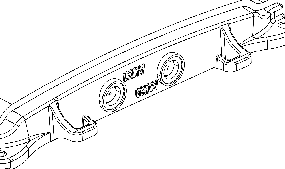

- Drill holes for SMA connectors.
- Guide through the card cables.
- Reassemble.
