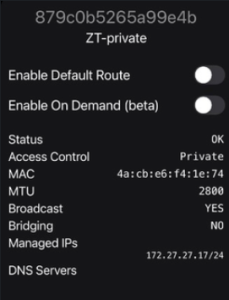

Each new peer asks for a controller to join the network, in this situation, we have ACCESS_DENIED status and we have to authorize a new peer, that is because we used the private=yes option.
After authorization, each member in the network receives information from the controller about new peers and approval they can exchange packets with them:

As previously, because our network is private, we have to authorize a new peer via "RouterOS home device". After that verify from controller received IP address and route:
[admin@Home] /zerotier> controller/member/print
Flags: A - AUTHORIZED
Columns: NETWORK, ZT-ADDRESS, IP-ADDRESS, LAST-SEEN
#    NETWORK     ZT-ADDRESS  IP-ADDRESS    LAST-SEEN
0 A  ZT-private  879a0b5265  172.27.27.15
1 A  ZT-private  554a914c7f  172.27.27.17
2 A  ZT-private  a83ac6032a  172.27.27.10
3    ZT-private  deba5dc5b1  172.27.27.13  3s348ms
[admin@Home] /zerotier> controller/member/set 3 authorized=yes

Download the ZeroTier app for your mobile phone or computer and join your newly created network:
1) Via our Laptop ZeroTier application we join the 879c0b5265a99e4b network;
2) User Zerotier mobile app to join the 879c0b5265a99e4b network;
Also all other new hosts you have to authorize under the /zerotier/controller/member/ section.
