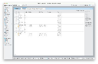

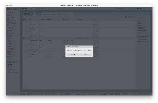

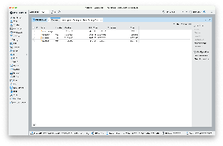

Since 7.18 it is possible to download/install extra packages directly from the router, using the System Packages section.
  1. After executing the Check For Updates command, available packages will be listed in the Packages list, but they will show up as disabled. The available package list comes from the MikroTik download server. Those packages are available, but not yet in your router (as indicated by the flags X (Disabled) and A (available).
  2. To download an extra package, first, select package and click Enable
  3. To make the router download the package, click Apply Changes and the device will ask for a reboot
This feature is also shown in our v7.18 announcement video.
Package listAfter loading the list with "Check for updates"Enabling a packageClicking "Apply Changes"

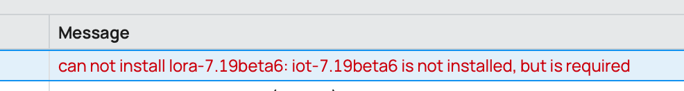

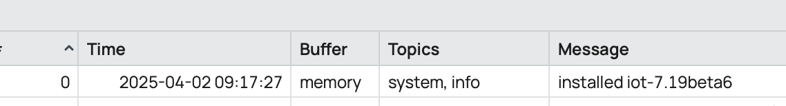

Verification of install
To make sure package is installed successfully, check the "Log" section after the device is rebooted. If the package is installed successfully, you will see a message about it. If there have been conflicts or some requirement is not met, this will be explained, so you can take further steps to rectify that.
