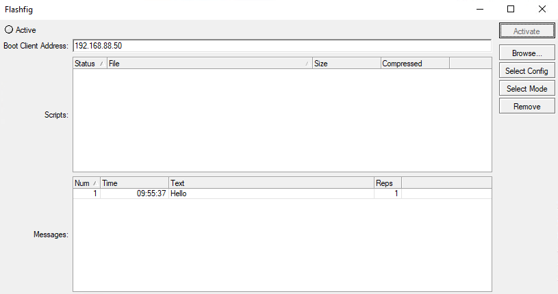

  • Run FlashFig;

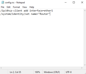

  • Prepare Config and/or Mode script .rsc file/s. Config and/or Mode script file is regular/import file, it accepts valid MikroTik RouterOS CLI commands. You can create .rsc file with any text editor program (Notepad, Notepad++, Texteditor, TextEdit, Microsoft Word, OpenOffice Writer)
  • Assign Boot Client Address, which should be an address within the same subnet as that configured on the computer's Ethernet interface,

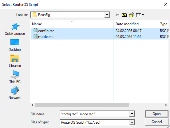

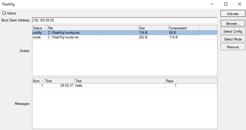

  • Browse for Config and/or Mode script .rsc files
  • Highlight Config script file and Select Config, highlight Mode script file and Select Mode

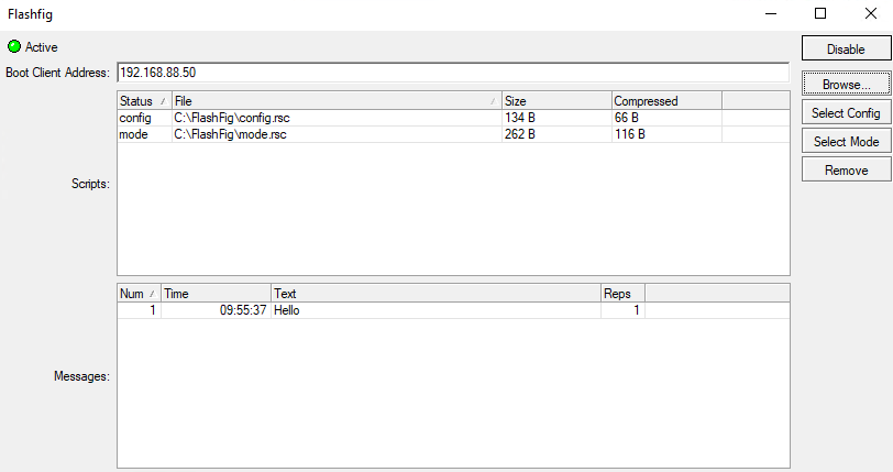

  • Activate FlashFig server, now it is ready to FlashFig. Note, any RouterBOARD will be FlashFig'ed within the network when they are powered on with boot-device configured to flash-boot or flash-boot-once-then-nand,

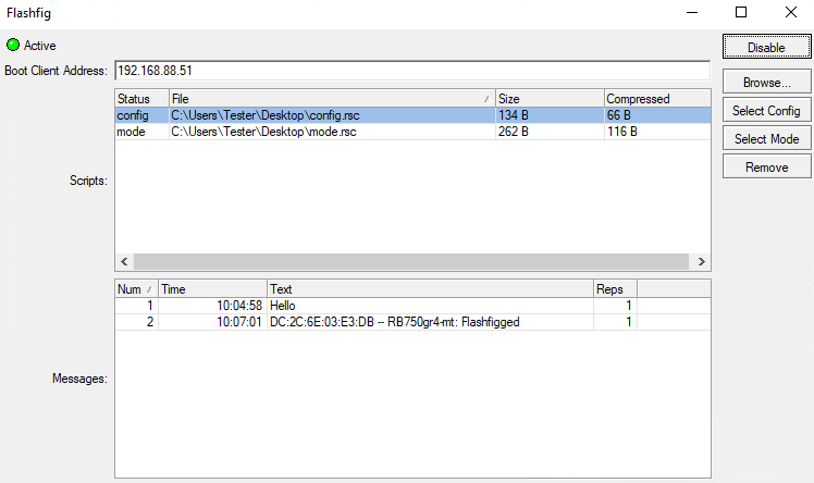

  • Check the status on FlashFig program
Messages log shows "Flashfigged" and RouterBOARD should repeatedly make the morse code sound for the character "/" ("_.._." and flash the LED - it is now safe to unplug / power down the router.
  • FlashFig configuration was applied to the RouterBOARD and it is ready to be used in production with this new config.
