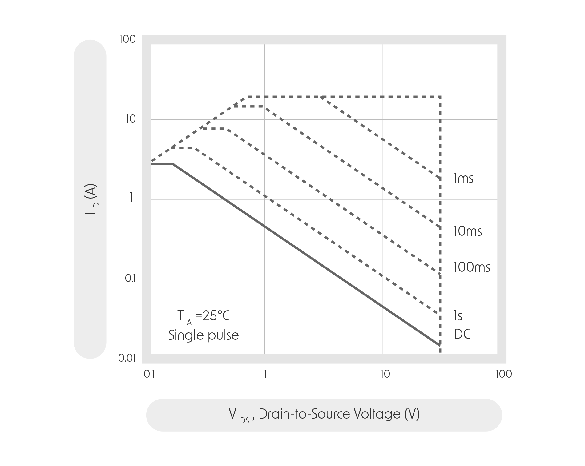

Connected relays (pin4 or pin6):
note: The maximum power dissipation (for digital output open drain transistor) is 0.48 W.It is recommended not to exceed 24V or 0.5A during continuous operation. Absolute maximum drain-source voltage is 30V , and the maximum amperage is 2.8A .
GPIO output has an open drain configuration. Logical state "0" (open transistor state) sets the output transistor in a low resistance state and the output is ~0V. Logical state "1" (closed transistor state) sets the output transistor in a high resistance state and the output voltage depends on the external circuit.
