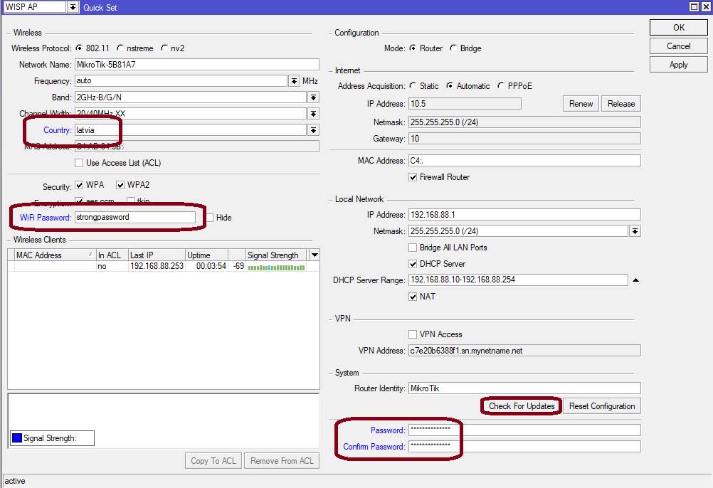

  • In the "QuickSet" menu set up the following: Choose your country, to apply country regulation settings;
  • Set up your wireless network password in the left field;
  • Set up your router password in the bottom field;

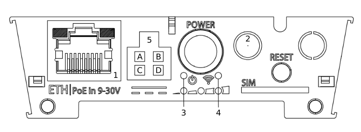

Expansion slots and ports
  1. 10/100 Ethernet port, supporting automatic cross/straight cable correction (Auto MDI/X). Either straight or crossover cable can be used for connecting to other network devices.
  2. External SMA antenna connector already connected to the LR9G card that is used for LoRa frequencies.
  3. External SMA antenna connector already connected to the LR9G card that is used for GPS reception.
  4. LED indicating the power state of the device.
  5. LED Indicating the activity of the Wireless network.
  6. Automotive connector. Pinout: A - reserved for future use (orange), B - reserved for future use (blue), C - ground (black), D – power in (red).
  • MiniPCIe slot with an integrated LR9G card.
  • Integrated Wireless module operating at 2.4 GHz, 802.11b/g/n protocol.
  • SIM Slot.

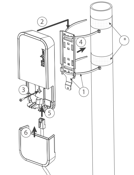

Mounting on the mast or pole:
* It's recommended to use electrical tape to increase friction between materials.
  1. Mount plastic tie straps to steel bracket guiding them through holes.
  2. Mount the bracket to the device.
  3. Secure them with a screw.
  4. Mount and align the device on the pole or mast.
  5. Guide the Ethernet cable through the opening and connect it to the Ethernet port.
  6. Close the bottom latch and secure it with a screw.
It's recommended to secure the Ethernet cable to the pole using zip ties. The distance from the device is approximately 30 cm.

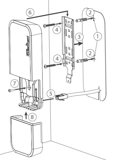

Mounting unit on the wall:
  1. Use included a template to mark spots for drilling holes. And if needed for Ethernet cable. Align accordingly, it will depend on how the device will be mounted finally.
  2. Insert dowels if needed, depending on the wall structure and material.
  3. Place included a steel bracket on the wall.
  4. Use screws to secure it in place.
  5. Extend your Ethernet cable through the opening and connect to the Ethernet port.
  6. Mount the device on the steel bracket
  7. Secure it in place with the screw.
  8. Close the bottom latch.
Avoid mounting the device on the low ground spot, as you won't be able to attach and close the bottom latch.

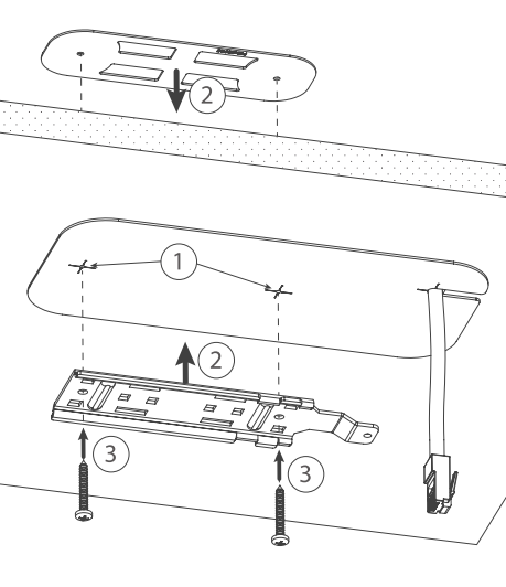

Mounting on the ceiling:
A Special bracket is included in the package to mount on the drop ceiling. As it consists of two parts, to be attached on both sides of the ceiling tile.
  1. Use the template to mark spots for holes.
  2. Place both mounting brackets on the spot.
  3. Secure them together using screws.
Continue assembling in the same manner if mounting on the wall.
  1. Extend your Ethernet cable through the opening and connect to the Ethernet port.
  2. Mount the device on the steel bracket.
  3. Secure it in place with the screw.
  4. Close the bottom latch.

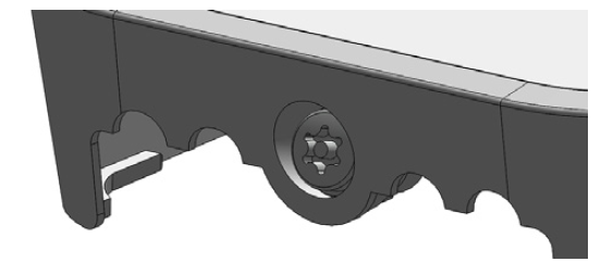

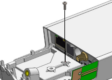

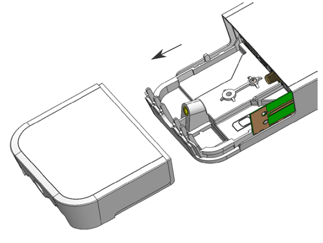

Bottom Lid
  • The bottom lid is secured in place with the captive screw.
  • Use a Torx T20 screwdriver to unscrew it, but do not remove the screw completely.
  • Pull the cover in the opposite direction from the device to remove it.
  • Reassemble.

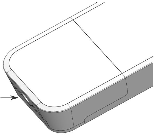

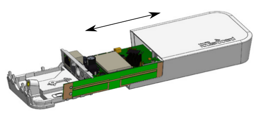

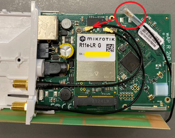

Internal antenna 2 dBi can be used for setups where the distance to the gateway is closer than 1km. By default, the antenna is not connected to the card! To use an internal antenna:
  • Use the PH2 screwdriver to remove the screw.
  • Disassemble the upper case from the bottom by sliding them to opposite sides.
  • Locate the internal antenna cable and attach it to the LR card (connector labeled "RFIO"):
  • The other connector (labeled "GPS"), is used for connecting GPS antennas.
  • Reassembly.
