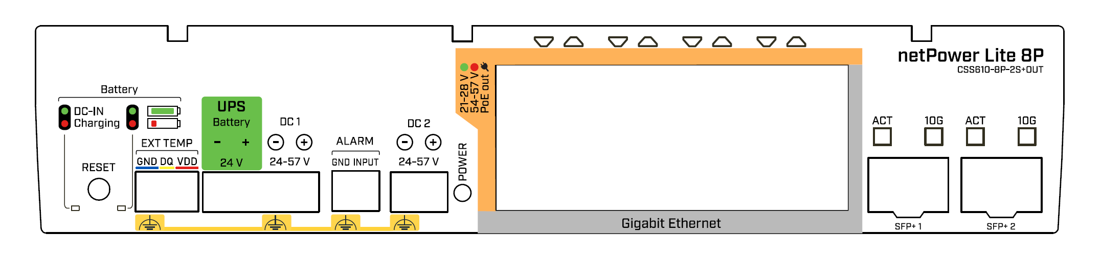

Expansion slots and ports
  1. Gigabit Ethernet: eight ports.
  2. PoE-out ports: Ether1-Ether8, 802.3af/at
    • Low voltage PoE-Out current limit: 1.0 A.
    • High voltage PoE-Out current limit: 0.64 A.
    • Total output power: 120 W.
  3. 10G SFP+ ports: two.
  4. Number of DC inputs: 3 (2-pin terminal).
    • 2-pin terminal input Voltage: 24-57 V.
    • 2-pin terminal input (Battery) Voltage 22-30 V.
    • 2-pin terminal charging (Battery) Voltage 20-31.7 V.
  5. Max power consumption: 208 W.
  6. Max power consumption without attachments: 7 W.
  7. External Temperature sensor: 3-pin terminal.
  8. Cooling type: Passive.

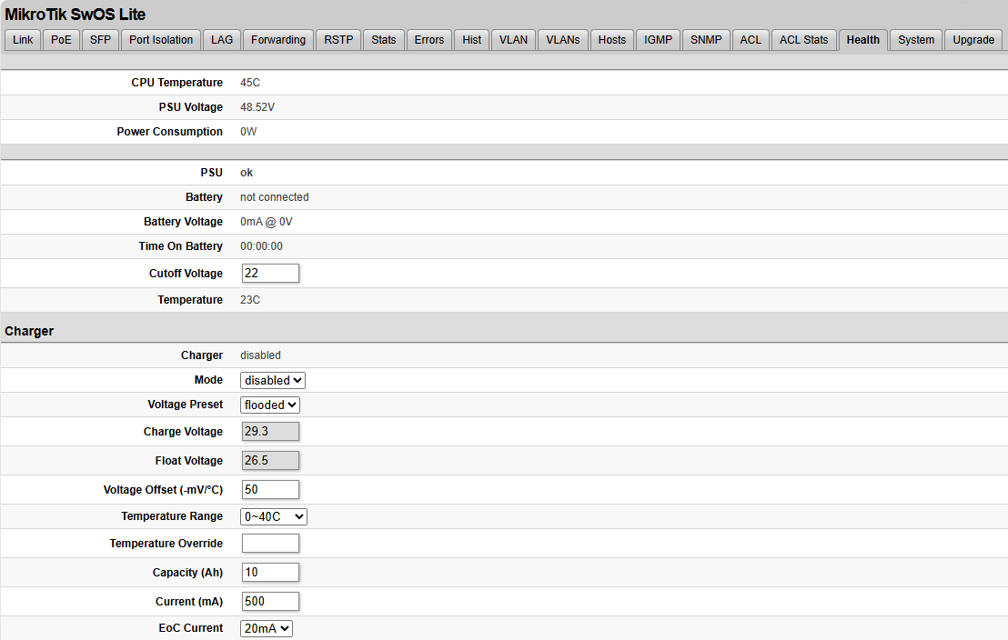

Battery Charger Parameters
The battery charger is configured under the SwOS Lite Health tab. The charger operates in 3 steps- the bulk, absorption and float phases, which are configured by the charger parameters.
Voltage Preset  allows for the selection of pre-defined float and charge voltages for the 4 relevant battery chemistries or, optionally, setting custom thresholds for the Charge and Float voltages.
The Current (mA) field allows setting the current at which the battery is charged during the bulk phase. During this phase, the battery voltage rises.
The Charge Voltage is the voltage at which the constant voltage is held in the absorption phase. During this phase, the battery current starts to decrease.
The EoC Current (End of Charge current) is the current at which the battery charger exits absorption and enters the float phase, relaxing to the float voltage.
The Float Voltage is the voltage at which the battery is held for some time, depending on the charger mode.
The EoC Current parameter values depend on the battery Capacity (Ah)
A 0.05C EoC Current value corresponds to a current that would charge the given battery capacity in 1/0.05C=20 hours. In other words, a 10Ah battery would have a 0.05C EoC current of 500mA.
There is a safety timer which will automatically enter the float phase if the battery has not finished the absorption phase in time. If the battery has not reached the EoC current in (Capacity/ Current)+30% minutes, the battery will end absorption and enter the float phase, if applicable.
As an example, a 10Ah capacity battery charged with a 1000mA charge Current setting will enter the float phase automatically in 780 minutes or 13 hours.
During the float phase, the charge current is limited to the EoC current + 20mA.
The charger can be set to disabled or to one of three charging modes that impact the float behavior:
Standby2 · Capacity (Ah) hours and remains active until blocked or reset Lead-acid batteries that are rarely cycled and must always be charged to their full capacity to be ready for a UPS application. The charge voltage is typically lower
Cyclic2 · Capacity (Ah) hours and remains disabled until reaching the self-discharge cutoffLead-acid batteries that are frequently cycled, but power is not available consistently, such as in a solar application. The charge voltage is slightly raised as there will not be time to fully float the battery
No-floatRemains disabled until reaching the self-discharge cutoff.Lithium batteries or other chemistries that are not meant to be float charged.
All three modes have the same absorption phase timeout. The self-discharge cutoff is 23.2V or the Cutoff Voltage parameter, whichever is highest. The Cutoff Voltage  can be set to a maximum of 26V.
When re-enabling the charger, it can take up to a minute before charging starts. The battery current and voltage is displayed in the Health tab. In case the connected DC supply browns out or has fluctuating power, the charger might prevent charging with the unstable power status.
The user is responsible for selecting appropriate battery charging parameters, taking into account the battery manufacturer provided specifications, BMS behavior and field conditions.
After changing any of the parameters in the Health tab Charger section, the charge cycle will restart from the bulk charging phase, if the charger is still enabled.
To prevent the charging of batteries at unsafe temperatures, the user can use the supplied temperature sensor.
The battery will not charge unless the sensor reads a value within the Temperature Range. This is set to 0°.. 40°C  by default or can be extended to -15°.. 50°C by the user.
In case the battery temperature is monitored and the batteries protected by some other means, the temperature can be overridden with the Temperature Override.
To prolong the life of lead acid batteries, the user can reduce the charge voltage down with higher battery temperatures. Conversely, the voltage is raised at lower temperatures. The center point around the adjustment is 25°C.
The Voltage Offset (-mV/°C) allows to fine-tune this adjustment. For instance, a value of 50 will lower the Charge Voltage and Float Voltage by 0.5V at 35°C.
In case this function is not used, the adjustment can be set to 0mV/C.
It is dangerous to raise the Charge Voltage for Lithium battery chemistries. The adjustment must be set to 0 in this case!
The supplied temperature sensor cannot be expected to fully prevent dangerous battery temperatures as it is dependent on the installation. To safeguard batteries under changing environmental conditions, the use of a suitable BMS is strongly recommended.
To control the battery depth of discharge, the parameter Cutoff Voltage can be used in the SwOS Lite Health tab.
Once the battery reaches the cutoff voltage, the system disconnects PoE-Out power and networking functions and enters a low-power state. The board will not be reachable at this state.
The board will exit the low-power state once a stable DC supply is reconnected or the battery is above the cutoff voltage and manually reconnected to the terminal. This is to prevent indefinite power-cycling due to reconnecting PoE-Out loads.

Powering
The device accepts power in three following ways:
  • DC1: 2-pin terminal accepts 24-57 V DC⎓.
  • DC2: 2-pin terminal accepts 24-57 V DC⎓.
  • Battery output voltage: 20-31.7 V DC⎓.
The power consumption under maximum load can reach 7 W, with attachments 29 W.
Power output
The device supports PoE-OUT 802.3af/at from Ethernet ports Ether1-Ether8.

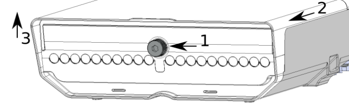

Bottom Lid
  1. The bottom lid is secured in place with the captive screw, it can be unscrewed by hand, but do not remove the screw completely.
  2. Pull the cover towards.
  3. Lift to access Ethernet ports.

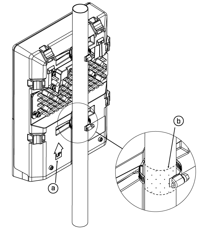

Mounting
The device can be mounted in several ways: pole, wall, or ceiling. The package also includes a drill hole template with detailed mounting instructions, to help you with the drill hole marking. The device has eight mounting points for versatility use zip ties or steel clamps for mounting on the pole.
The IP rating scale for this device is IP54. When mounting outdoors, please ensure that any cable openings are directed downwards.
Mounting points:
  • There are eight mounting points on the back of this device. Choose the most relevant ones.
  • Middle points are designed for mounting on the mast, there are curves on the case for slim fitment.
 It's recommended to secure Ethernet cable to the pole using zip ties. With the distance from the device approximately 30 cm.
The device must be mounted by UP arrow facing upwards.
 The installation infrastructure (towers and masts), as well as the router itself, must be properly grounded. The device includes a grounding wire attachment screw on the backside.
  • Attach your grounding wire to the grounding screw.
  • Attach the other end of the grounding wire to the grounded mast.
Mounting and configuration of this device should be performed by a qualified person.
Mounting on the mast or pole:
  1. Insert provided steel clamps into mounting spots.
  2. Attach the unit to the mast.
  3. Align the device and secure it by tightening steel clamps with a PH2 screwdriver.
  4. Guide Ethernet cables through the opening and connect to the Ethernet ports.
  5. Close bottom latch and secure with a screw.
A - Always make sure to place the unit in an upwards position.
B - It's recommended to use electrical tape to increase friction between materials.

Buttons and jumpers
Hold this button during boot time until the LED light starts to flash. Release the button to reset SwOS configuration and load backup software for reinstallation and upgrade.
