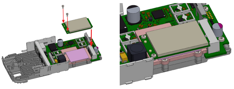

  • Locate miniPCIe slot on your device;

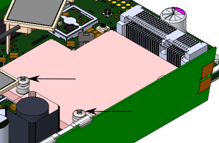

  • Unscrew two factory attached screws;

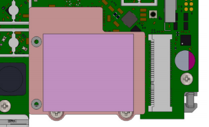

  • Optionally you can use the thermal pad by placing it under the card, the thermal pad is not included in the package;
  • Install the module to the miniPCIe slot and secure it with previously removed screws. Tightening torque 0,3 Nm.

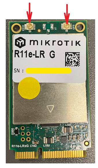

Attach LoRa antenna cable to the "RFIO"-labeled connector for LoRa usage, and attach GPS antenna cable to the "GPS"-labeled connector for GPS usage:

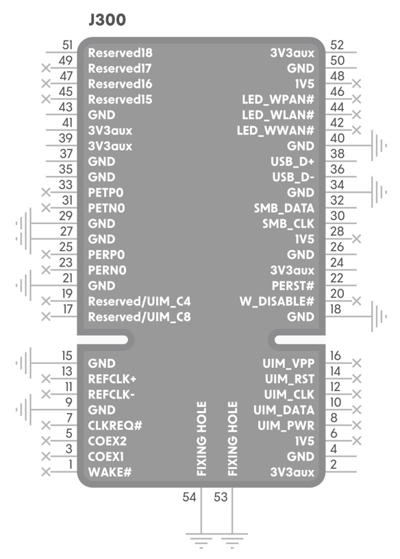

This warning only applies to mPCIe cards that are already preinstalled in MikroTik gateway devices, like WAP LR9. It is important to note here, that using pins 39 and 41 is mandatory. If you want to use the card elsewhere, note that some USB to mPCIe adapters do not have mentioned pins connected and, without them, the LoRa card will not work. For a more detailed pinout, check the section below.
Pinout

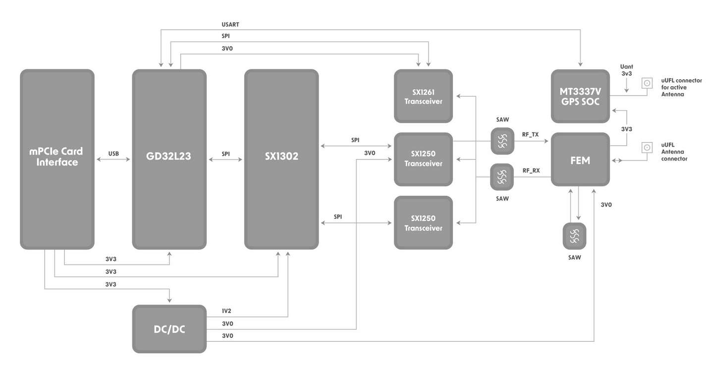

Block diagram
