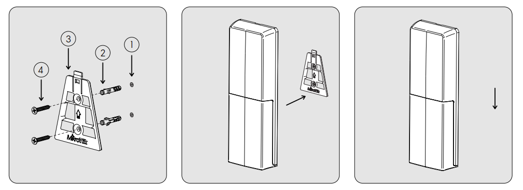

Mounting unit on the wall:
  1. Place the bracket at the location where you plan to install the device and mark spots for drilling holes and, if needed, for cables. Align accordingly, depending on the final mounting position of the device.
  2. Drill the holes.
  3. Insert included dowels if needed, depending on the wall structure and material.
  4. Screw the included bracket onto the wall or ceiling.
  5. Mount and align the device on the previously installed bracket.
  6. Unscrew the bottom lid screw and open the lid.
  7. Guide the cables through the opening and connect them to the appropriate ports.
  8. Close the bottom lid and secure it with a screw.

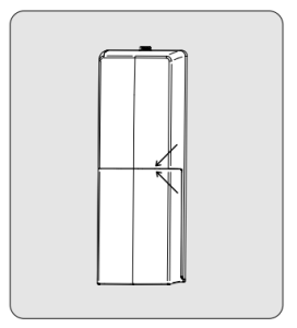

Bottom Lid
  • The bottom lid is secured in place with the screw.
  • Use the Philips PH2 screwdriver to unscrew it.
  • Pull the lid in the opposite direction from the device to remove it.
  • Reassemble.

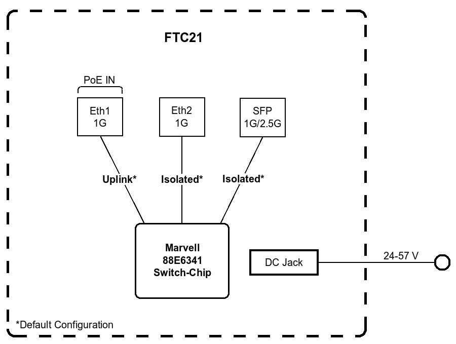

The device accepts power from the power jack or from the Ethernet port:
  • Direct-input power jack (5.5 mm outside and 2 mm inside, female, pin positive plug) accepts 24-57 V ⎓ DC;
  • Ethernet1 port accepts 802.3af/at.
The maximum power consumption without attachments is 3W, and under maximum load, it can reach 4W.

Expansion slots and ports
  • Two 10/100/1000 Ethernet port, supporting automatic cross/straight cable correction (Auto MDI/X). Either straight or crossover cable can be used for connecting to other network devices.
  • One 1G/2.5G SFP port.
The uplink is a configurable parameter and can be set to any port, remaining two ports become isolated.
By default Ether1 is uplink and Ether2, SFP ports are isolated.
