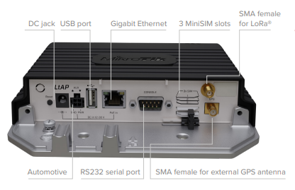

Extension slots and ports
  • Built-in 2 GHz wireless access point module, AP/station/bridge/p2p modes are supported. Onboard PIF antennas built-in, as well as MMCX connectors for external antennas (software selectable).
  • Two miniPCIe slots and three SIM slots. The first slot (on the bottom) is used by the LTE modem, which is connected to an internal LTE antenna. Second slot (on the upper side) is used by the R11e-LR8G card, which is connected to the external SMA connector
  • Built-in GPS module with an external SMA connector.
  • Gigabit Ethernet port, supporting automatic cross/straight cable correction (Auto MDI/X). Either straight or crossover cable can be used for connecting to other network devices. The Ethernet port accepts 12-30 V DC powering from a passive PoE injector.
  • One DB9 RS232 serial port for serial console access. Configured as 115200 bit/s, 8 data bits, 1 stop bit, no parity.
  • One USB 2.0 port.

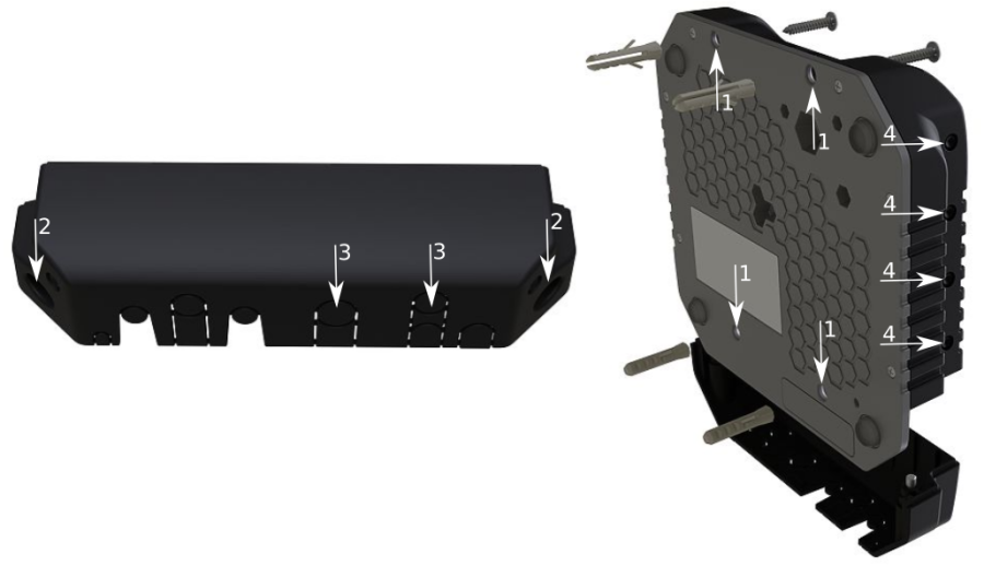

Mounting
  1. It is possible to attach the device to a wall, using the provided four screws and designed four holes on the unit.
  2. The ports are protected with a small door, that is held in place with two screws. Remove to access Ethernet ports, antenna connector, SIM slots, etc.
  3. The door has cut-out places for all available ports, so you can guide through all necessary cables, but please only break out the openings that you will use.
  4. Several places for external antennas are provided on the case, use an appropriate size drill, to make them available. Be careful and measure the chosen antenna, so that it does not touch the internal PCB board when installed.
The device can be used both indoors and outdoors. The IP rating scale of IP54.
If you intend to mount outdoors, please ensure that any cable openings are directed downwards. The Mounting direction is indicated on the device with an arrow pointing up. Use POE injector and proper grounding. Recommended using Cat6 shielded cable.
Warning! This equipment should be installed and operated with a minimum distance of 30 cm between the device and your body. Operation of this equipment in the residential environment could cause radio interference.
The device enclosure has places where you can drill openings for external LTE and GPS antennas. Use a drill to make holes that are appropriate for the antenna cable used.

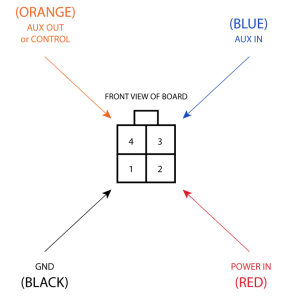

Automotive connector usage
Powering
  • Direct-input power jack (5.5 mm outside and 2 mm inside, female, pin positive plug) accepts 12-30 V DC ⎓ with provided 24 V, 1.2 A adapter.
  • Ethernet port accepts passive Power over Ethernet 12-30 V DC ⎓ (compensate for the loss on cable, so more than 12 V recommended).
  • The automotive connector can be used to power the device from regular 12/24 V ⎓ connections in automobiles and buses. The plug has four pins: bottom left (black) is the ground, bottom right is power in (red). The upper two (AUX) are reserved for future use.

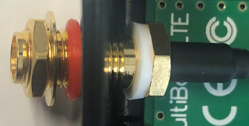

  8. When using external antennas, connectors can be attached on the case sides, to make openings use a 6.5 mm drill bit, please see LtAP kit-series#Mounting section part 4;
  9. Please see the picture below for reference on how to place rubber seals for best water protection;
