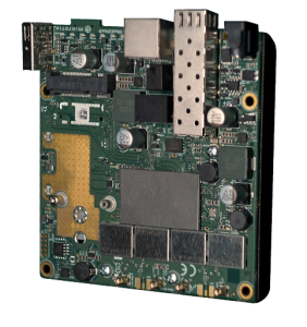

Quickstart
Please follow these quick steps to set up your device:
  • This product comes without enclosure and is designed to be installed into the users' end products or enclosures. Compatible with the CA411-711 and CA433U MikroTik enclosures.
  • The device comes in ESD protective packaging. When handling electrical equipment please observe the following safety precautions:
    • Use a wrist grounding strap when unpacking and working with electrical components to avoid electrical discharge (ESD) damage;
    • After unpacking please place the router on the anti-static mat;
    • When mounting the unit make sure there are no objects that can damage or touch the PCB plate;
    • The device can be mounted in your desired location using the factory-provided holes in a PCB plate, located on each side of the device;
  • Connect an external antenna (mandatory);
  • Connect the device to the power source;
  • Navigate to the network connections section on your computer and locate the wireless network named "MikroTik-...". Proceed to connect to it (check the wireless passwords on the sticker);
  • Configuration should be made via a wireless network using a mobile application or you can use the WinBox configuration tool https://mt.lv/winbox;
  • Download and open WinBox, and choose the Neighbors tab to find the device;
  • Click on the MAC address. The username is "admin" and there is no password (or, for some models, check user and wireless passwords on the sticker);
  • For a manual update of the device, visit the products page at https://mikrotik.com/products to find your product. The required packages are accessible under the "Support&Downloads" menu;
  • Upload downloaded packages to the WinBox Files menu and reboot the device. By upgrading your RouterOS software to the latest version, you can ensure optimal performance, stability, and security updates;
  • In the QuickSet menu set up the following: Choose your country, to apply country regulation settings;
  • Set up your wireless network password in the left field;
  • Set up your router password in the bottom field;
  • If you need to use a SIM card, install your desired modem into miniPCIe slot;
  • Insert a Nano SIM card into the slot.

Expansion slots and ports
  • One gigabit Ethernet port; supports 18-28 V DC input via passive PoE injector.
  • One SFP port (2.5G supported).
  • One USB type A port.
  • One MiniPCI-e slots.
  • One SIM slot (Nano SIM).
  • 2 external MMCX antenna connectors.
  • Integrated Wireless module operating at 5 GHz, 802.11a/n/ac/ax protocol.
