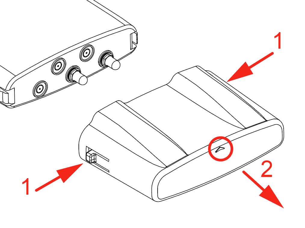

Removing upper cover
  • To remove the upper cover, press both side clips.
  • Pull cover to the side while holding the body. When assembling please not mark on the top cover or reference.

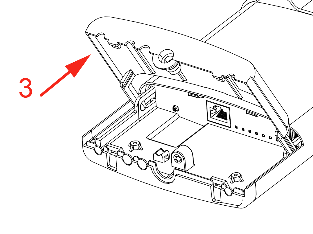

Opening bottom cover
  • To open the bottom cover, unscrew the locking screw.
  • Pull cover slightly from the device body.
  • Lift it, but do not remove it completely.

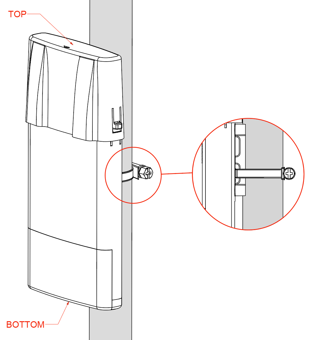

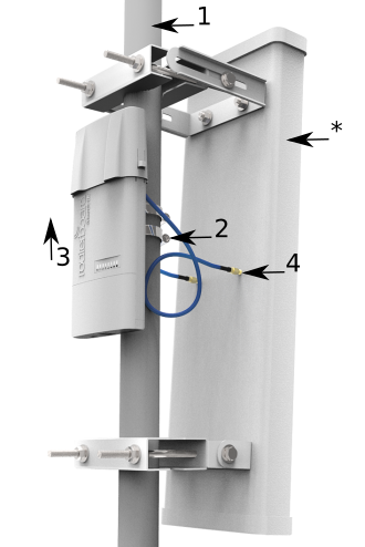

Mounting on the pole
The Mounting hose clamp is provided with the package.
  • Guide hose clamp through the opening on the back of the device and attach it to the mast.
  • Align and secure with hose clamp screw using PH2 screwdriver.
  • The device should be always placed by TOP cover facing upwards.
  • Connect your antenna.
  • The antenna is no provided with the device only for illustration purposes.

The installation infrastructure (towers and masts), must be properly grounded.
Please secure all loose Ethernet cables and antenna cables to the pole or mast approximately 30cm from the device, so that the cable weight is not pulling the ports and connectors.

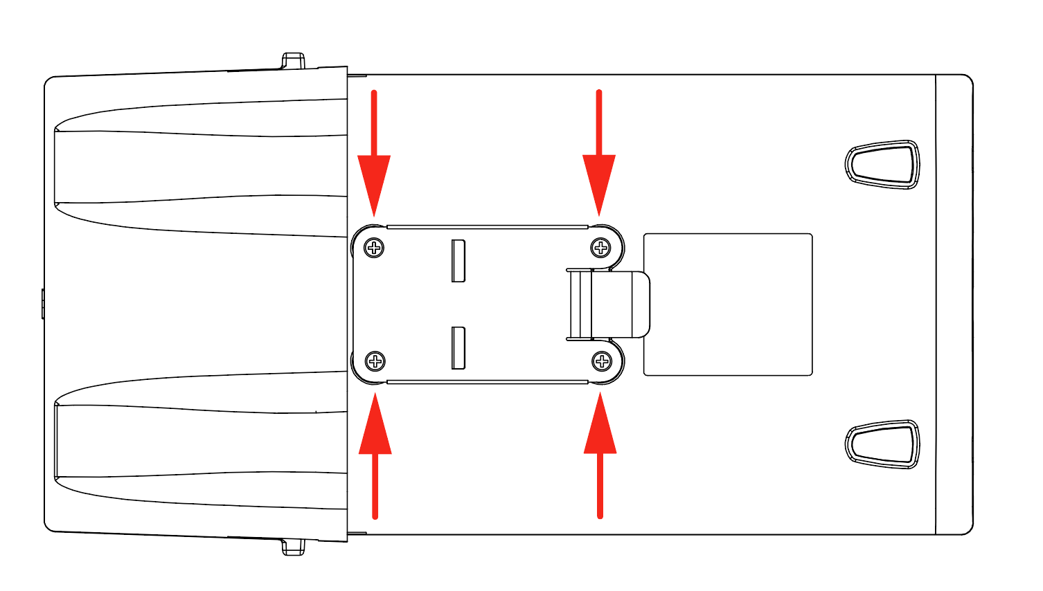

Mounting using DIN rail
When mounting on the DIN rail, please find a special bracket in the package and secure it with four screws to the back of the unit. With the attached mounting bracket you will be able to slide the device on the DIN rail.

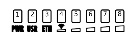

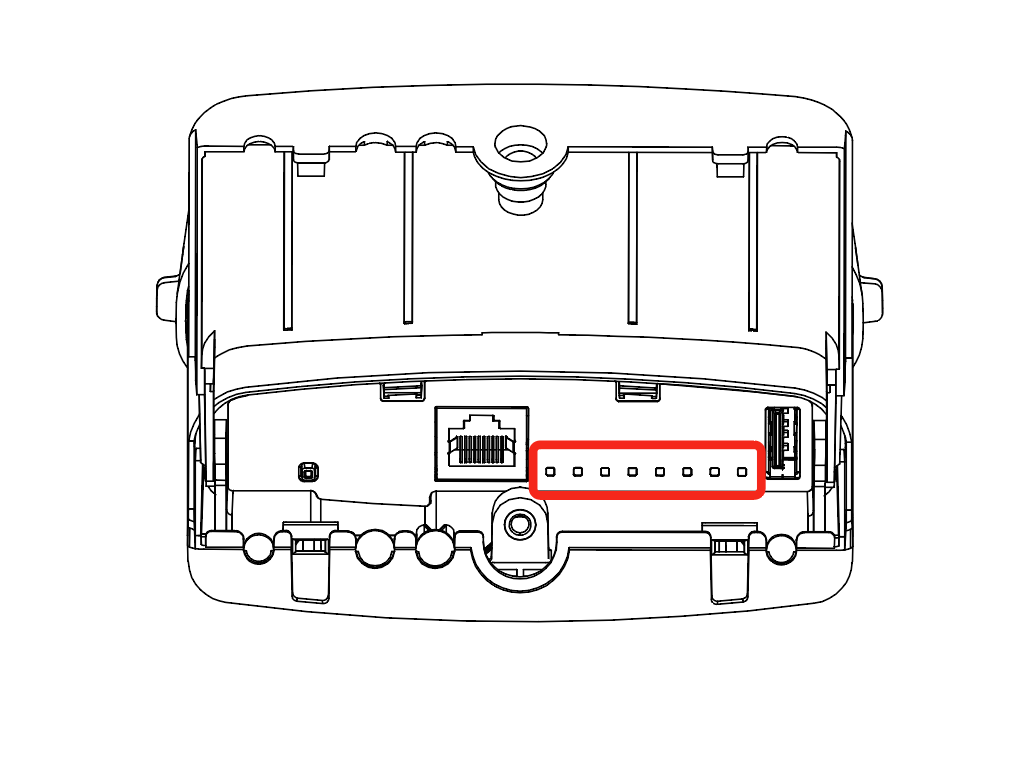

Front status LED behavior
The LEDs are located under the bottom cover.
RouterOS allows configuring each LED's activity the way that the user wishes. It is possible to configure the LEDs to display wireless strength, blink the LEDs on interface traffic activity and many other options. For further information please visit https://help.mikrotik.com/docs/display/ROS/LEDs
Default factory configuration for this device:
  1. Solid Blue – The device is powered on.
  2. Solid Green – Indicates the device's state while powering it up into different modes, such as resetting the configuration or booting device for the Netinstall utility.
  3. Solid Green – Active Ethernet port.
  4. 4-8 Solid Green – The set of five green LEDs, shows the signal strength.

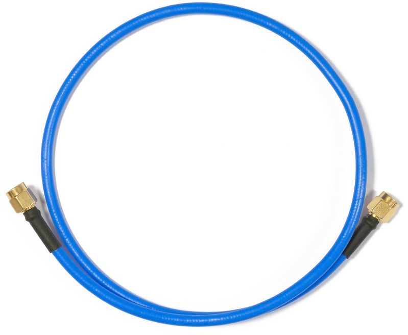

Antenna usage
To connect to the external antenna please use, the "Flex-guide" - can be obtained separately. A super low loss 50cm long RPSMA cable for superior connection quality, suited for indoor and outdoor use, this cable provides superior matching and loss values. https://mikrotik.com/product/ACRPSMA
SMA connectors located under the upper cover (see "Removing upper cover") to access them.
Please connect and disconnect the antenna, when the device is turned off!
