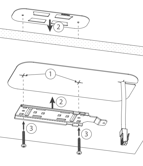

The device can be mounted in several ways: wall, ceiling, pole or it can be placed in specially designed Mikrotik holder which comes with the package. The package includes a drill hole template with instructions, to help you with the Ethernet cable installation and attachment to a ceiling or a wall. The package also includes a steel bracket to put on the other side of a dropdown ceiling tile and two screws and wall anchors. The Unit can be attached to the pole using zip ties or steel clamp.
To prevent the bottom lid for opening the different screw can be used. One Torx T20 security screw is included for optional use. Use it with the included L-shaped wrench to fix it into the bottom lid. Detailed instructions of replacing screw are in the package.

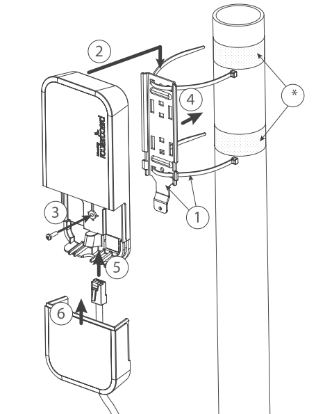

Mounting on the mast or pole:
* It's recommended to use electrical tape to increase friction between materials.
  1. Mount plastic tie straps to steel brackets guiding them through holes.
  2. Mount bracket to the device.
  3. Secure them with a screw.
  4. Mount and align the device on the pole or mast.
  5. Guide Ethernet cable through the opening and connect to the Ethernet port.
  6. Close bottom latch and secure with a screw.
It's recommended to secure Ethernet cable to the pole using zip ties. With the distance from the device approximately 30 cm.

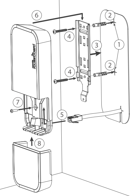

Mounting unit on the wall:
  1. Use included a template to mark spots for drilling holes. And if needed for Ethernet cable. Align accordingly, it will depend on how the device will be mounted finally.
  2. Insert dowels if needed, depends on wall structure and material.
  3. Place included a steel bracket on the wall.
  4. Use screws to secure it in the place.
  5. Extend your Ethernet cable through the opening and connect to the Ethernet port.
  6. Mount the device on the steel bracket
  7. Secure it in place with the screw.
  8. Close bottom latch.
Avoid mounting the device on the low ground spot, as you won't be able to attach and close the bottom latch.

A Special bracket is included in the package to mount on the drop ceiling. As it consists of two parts, to be attached on both sides of the ceiling tile.
  1. Use the template to mark spots for holes.
  2. Place both mounting brackets on the spot.
  3. Secure them together using screws.
Continue assembling in the same manner if mounting on the wall.
  1. Extend your Ethernet cable through the opening and connect to the Ethernet port.
  2. Mount the device on the steel bracket.
  3. Secure it in place with the screw.
  4. Close bottom latch.

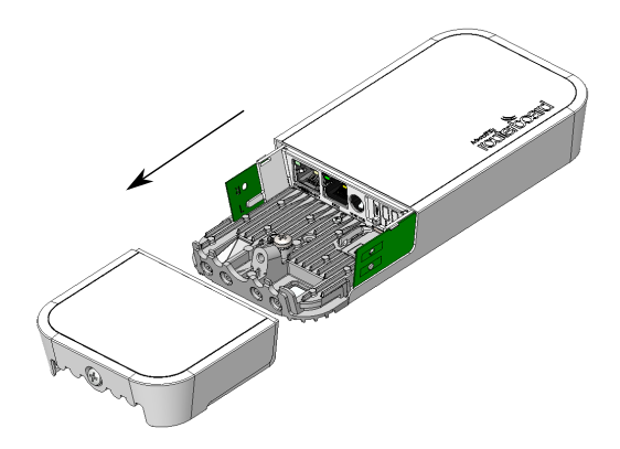

Bottom Lid
  • The bottom lid is secured in place with the captive screw.
  • Use the Philips PH2 screwdriver to unscrew it, but do not remove the screw completely.
  • Pull the cover in the opposite direction from the device to remove it.
  • Reassemble.
