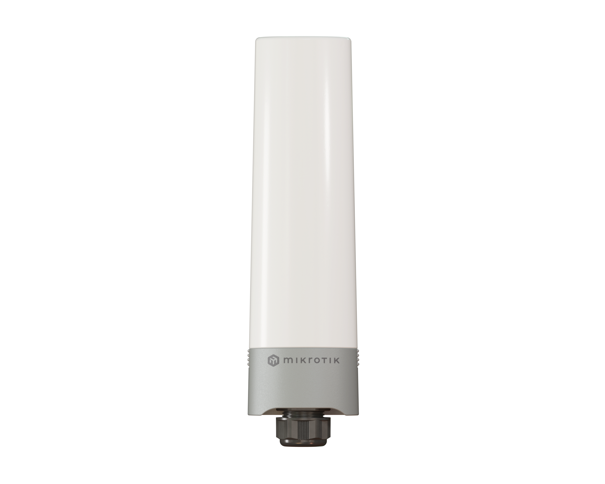

The device is designed for use outdoors, the IP rating scale for this device is IP68. It is possible to attach the device on the pole, using the provided screw hole on the mounting bracket of the unit.

- 1 PoE-in 802.3bt Gigabit Ethernet port.
- 3 PoE-out 802.3af/at Gigabit Ethernet ports.
- 1 two-pin connector DC power voltage slot in the range of 24 to 57V⎓.
