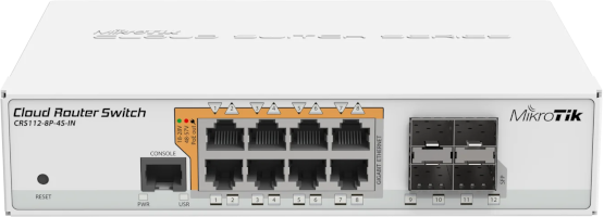

CRS112-8P-4S-IN
The CRS112 is a network switch with eight-gigabit Ethernet ports and four SFP ports. It is already configured, with all ports switched together. We recommend you to set up a password to secure your device. This unit is compatible with 1.25G SFP modules. The CRS112-8P is capable of powering other devices through PoE.

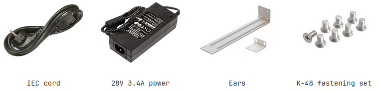

Powering
The device has two direct-input power jacks (5.5 mm outside and 2 mm inside, female, pin positive plug). One DC input supports 48-57 V DC, the other supports 18-28 V DC. Only a 28 V PSU is included. You can use either one or both inputs at the same time. This will also affect the PoE output functionality (see below section). The power consumption of this device itself under maximum load is up to 12 W.

The device is designed to be used indoors and placed on a flat surface with all needed cables connecting to the front of the unit. If the desired mounting location is a rackmount enclosure, please attach the rackmount mounting brackets to both sides of the device and secure with screws firmly.
