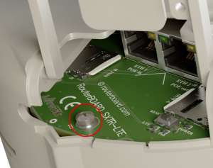

- The grounding wire should be connected to the RouterBOARD grounding wire attachment point if such is provided. This wire should then be connected to the base of the tower, ensuring the connection meets grounding standards. The antenna's grounding wire should be connected near the RouterBOARD outdoor case and can be joined with the same grounding wire used for the RouterBOARD.

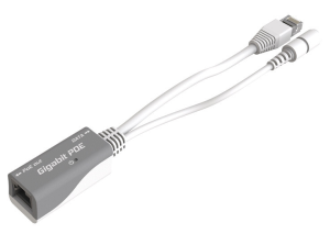

PoE injector with shielded connectors:
RouterBOARD grounding wire attachment points:
