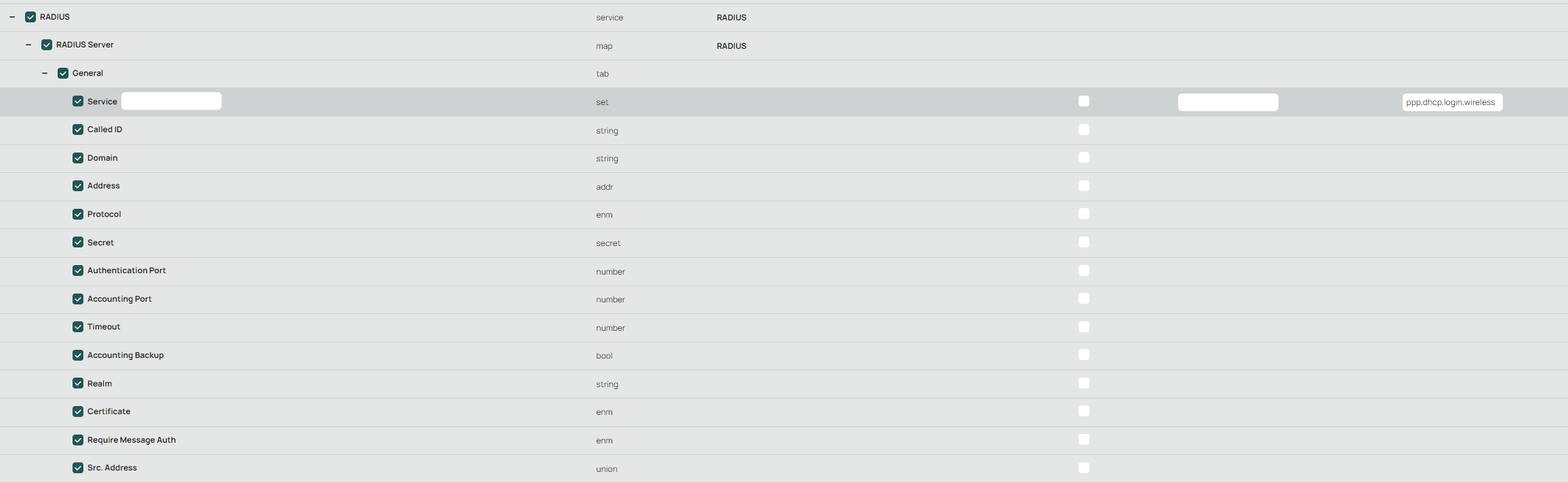

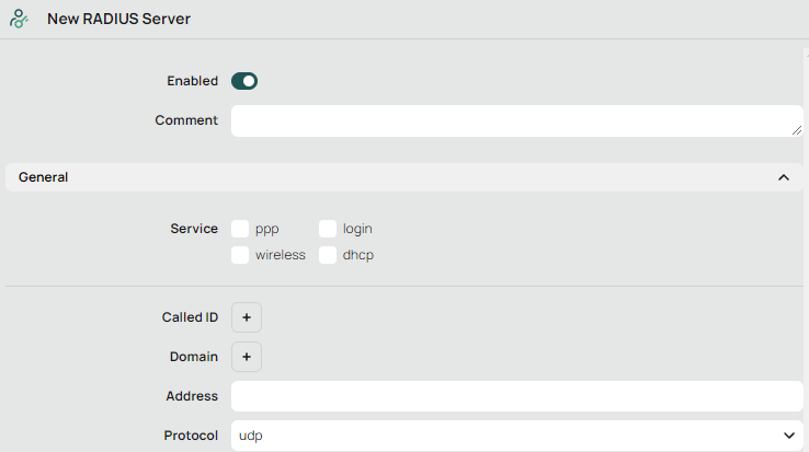

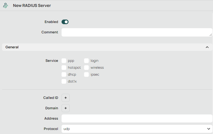

If you need to limit the user for some services
Add a limit to the RADIUS Service.
The result will be only those services, that are pointed in the "Limit" field.
