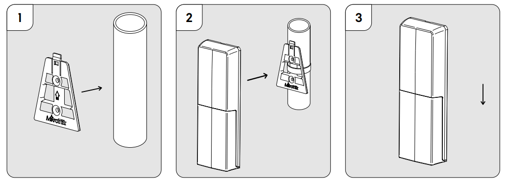

Mounting on the mast or pole:
  1. Mount the included bracket to the pole or mast using steel hose clamp (not included) , guiding it through the hole.
  2. Mount and align the device on the previously installed bracket on the pole or mast.
  3. Unscrew the bottom lid screw and open the lid.
  4. Guide the cables through the opening and connect them to the appropriate ports.
  5. Close the bottom lid and secure it with a screw.
It's recommended to secure Ethernet cable to the pole using zip ties. With the distance from the device approximately 30 cm.

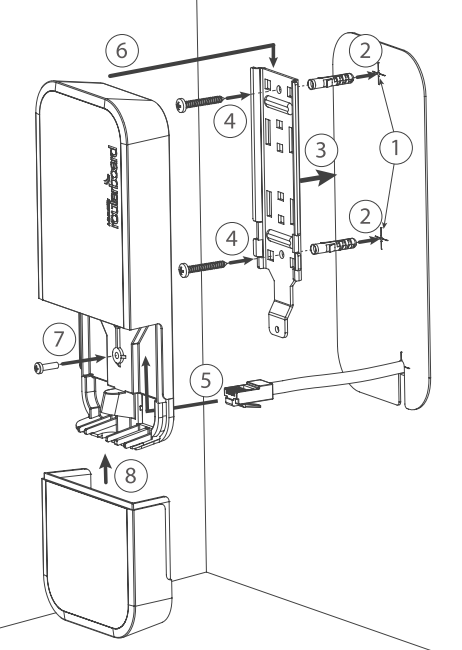

Mounting unit on the wall:
  1. Place the bracket at the location where you plan to install the device and mark spots for drilling holes and, if needed, for cables. Align accordingly, depending on the final mounting position of the device.
  2. Drill the holes.
  3. Insert included dowels if needed, depending on the wall structure and material.
  4. Screw the included bracket onto the wall or ceiling.
  5. Mount and align the device on the previously installed bracket.
  6. Unscrew the bottom lid screw and open the lid.
  7. Guide the cables through the opening and connect them to the appropriate ports.
  8. Close the bottom lid and secure it with a screw.

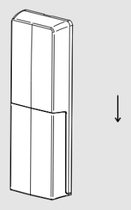

Bottom Lid
  • The bottom lid is secured in place with the screw.
  • Use the Philips PH2 screwdriver to unscrew it.
  • Pull the lid in the opposite direction from the device to remove it.
  • Reassemble.
