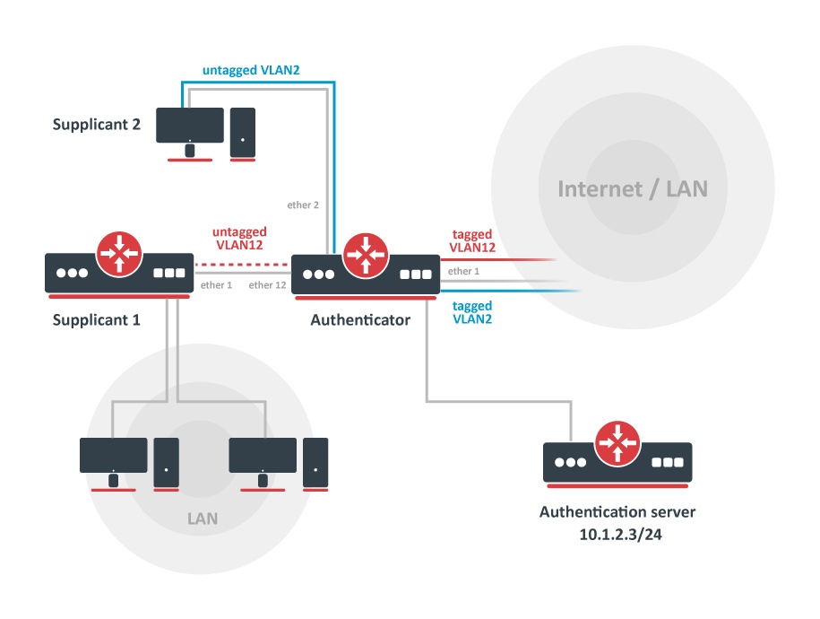

Port based VLAN ID assignment
It is possible to assign an authenticated interface to a specific VLAN ID using bridge VLAN filtering. This can be done using RADIUS Tunnel-Type, Tunnel-Medium-Type and Tunnel-Private-Group-ID attributes. Note that only devices with hardware offloaded VLAN filtering will be able to do this in switch chip.
First of all, make sure the interface is added to a bridge which has VLAN filtering enabled.
Code Block
languageros
add name=bridge1 vlan-filtering=yes
add bridge=bridge1 interface=ether2
add bridge=bridge1 interface=ether12
It is necessary to add static VLAN configuration for tagged VLAN traffic to be sent over ether1 interface.
Code Block
languageros
/interface bridge vlan
add bridge=bridge1 tagged=ether1 vlan-ids=2
add bridge=bridge1 tagged=ether1 vlan-ids=12
With enabled RADIUS debug logs it is possible to see complete RADIUS message packets with all attributes. In our example, Tunnel attributes are received in Access-Accept message from RADIUS server:
Code Block
languagetext
09:51:45 radius,debug,packet received Access-Accept with id 64 from 10.1.2.3:1812
09:51:45 radius,debug,packet     Tunnel-Type = 13
09:51:45 radius,debug,packet     Tunnel-Medium-Type = 6
09:51:45 radius,debug,packet     Tunnel-Private-Group-ID = "12"
09:51:45 radius,debug,packet     User-Name = "dot1x-user"
The VLAN ID is now present in active session list and untagged ports are added to previously created static VLAN configuration.

In our example, Supplicant2 on ether2 is only allowed to access the 192.168.50.0/24 network with UDP destination port 50, all other traffic should be dropped. First, make sure that hardware offloading is working on bridge ports, otherwise switch rules might not work properly.
Code Block
languageros
/interface bridge port print
Flags: X - disabled, I - inactive, D - dynamic, H - hw-offload
 #     INTERFACE                   BRIDGE                   HW  PVID PRIORITY  PATH-COST INTERNAL-PATH-COST    HORIZON
 0   H ether1                      bridge1                  yes    1     0x80         10                 10       none
 1   H ether2                      bridge1                  yes    1     0x80         10                 10       none
 2   H ether12                     bridge1                  yes    1     0x80         10                 10       none
With enabled RADIUS debug logs it is possible to see complete RADIUS message packets with all attributes. In our example, Mikrotik-Switching-Filter attribute is received in Access-Accept message from Radius server:
Code Block
languagetext
02:35:38 radius,debug,packet received Access-Accept with id 121 from 10.1.2.3:1812
02:35:38 radius,debug,packet     MT-Switching-Filter = "mac-protocol 2048 dst-address 192.168.50.0/24 dst-port 50 protocol 17 action allow,action drop"
