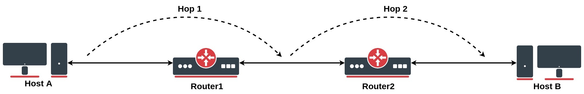

OverviewRouting is the process of selecting paths across the networks to move packets from one host to another. How Routing WorksLet's look at a basic configuration example to illustrate how routing is used to forward packets between two local networks and to the Internet. In this setup, we have several networks: - two client networks (192.168.2.0/24 and 192.168.1.0/24);
- one network to connect routers (172.16.1.0/30), usually called backbone;
- the last network (10.1.1.0/24) connects our gateway router (Router1) to the internet.

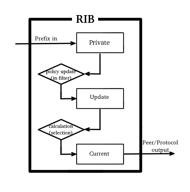

Each Route has three copies of route attributes: - private -- what is received from the peer, before passing in-filters.
- updated -- what is the result of applying in-filters.
- current -- what are the attributes currently used by the route.
!!!!! Need option to print private !!!!! Periodically (when needed), update attributes are calculated from private attributes. This happens when route update is received, or when in-filter is updated. When the routing table is recalculated, current attributes are set to the value from updated attributes. This means, that usually if there is no in-filter that changes route attributes, private, updated, and current share the same value. Route attributes are kept in several groups: - L1 Data - all flags, list of extra properties, as-path;
- L2 Data - nexthops, RIP,OSPF,BGP metrics, route tags, originators etc.
- L3 Data - distance, scope, kernel type, MPLS stuff
- extra properties - communities, originator, aggregator-id, cluster-list, unknown
Having for example many different combinations of distance and scope route attributes will use more memory! Matching communities or as-path using regexp will cache the result, to speed up filtering. Each as-path or community value has a cache for all regexp, which is filled on-demand with match results. Note: WORST CASE: changing attributes in 'in-filter' will make the route program use more memory! Because 'private' and 'updated' attributes will be different! Having a lot of different regexps will make matching slow and use a lot of memory! Because each value will have a cache with thousands of entries! Detailed info about used memory by routing protocols can be seen in /routing stats memory menu FIB (Forwarding Information Base) contains a copy of the information that is necessary for packet forwarding: - all active routes

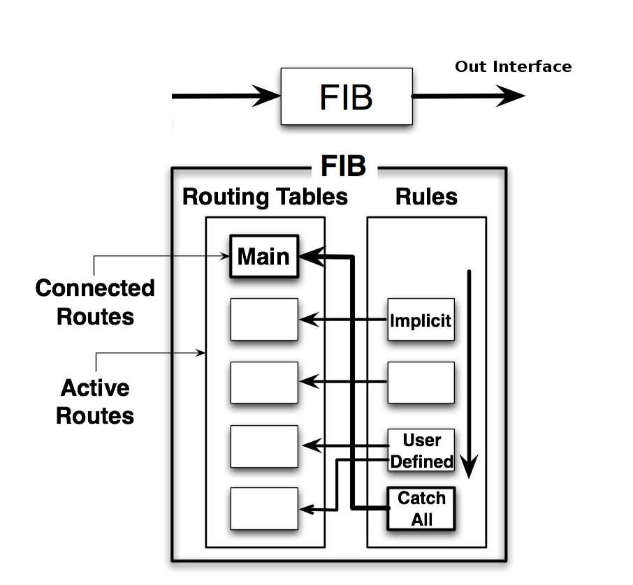

- policy routing rules
Each route has dst-address property, that specifies all destination addresses this route can be used for. If there are several routes that apply to a particular IP address, the most specific one (with the largest netmask) is used. This operation (finding the most specific route that matches the given address) is called ''routing table lookup''. Only one Best route can be used for packet forwarding. In cases where the routing table contains several routes with the same dst-address, all equally best routes are combined into one ECMP route. The best route is installed into FIB and marked as ''active''. When forwarding decision uses additional information, such as the source address of the packet, it is called policy routing. Policy routing is implemented as a list of policy routing rules, that select different routing tables based on destination address, source address, source interface, and routing mark (can be changed by firewall mangle rules) of the packet. Routing table lookup
FIB uses the following information from the packet to determine its destination: - source address
- destination address
- source interface
- routing mark
Possible routing decisions are: - receive packet locally
- discard the packet (either silently or by sending an ICMP message to the sender of the packet)
- send the packet to a specific IP address on a specific interface
Run routing decision: - check that packet has to be locally delivered (the destination address is the address of the router)
- process implicit policy routing rules
- process policy routing rules added by a user
- process implicit catch-all rule that looks up destination in the ''main'' routing table
- the returned result is "network unreachable"
The result of the routing decision can be: - IP address of nexthop + interface
- point-to-point interface
- local delivery
- discard
- ICMP prohibited
- ICMP host unreachable
- ICMP network unreachable
Rules that do not match the current packet are ignored. If a rule has action: - drop or unreachable, then it is returned as a result of the routing decision process.
- lookup then the destination address of the packet is looked up in the routing table that is specified in the rule. If the lookup fails (there is no route that matches the destination address of the packet), then FIB proceeds to the next rule.
- lookup-only similar to lookup except that lookup fails if none of the routes in the table matches the packet.
Otherwise: - if the type of the route is blackhole, prohibit, or unreachable, then return this action as the routing decision result;
- if this is a connected route or route with an interface as the gateway value, then return this interface and the destination address of the packet as the routing decision result;
- if this route has an IP address as the value of gateway, then return this address and associated interface as the routing decision result;
- if this route has multiple values of nexthop, then pick one of them in round-robin fashion.
